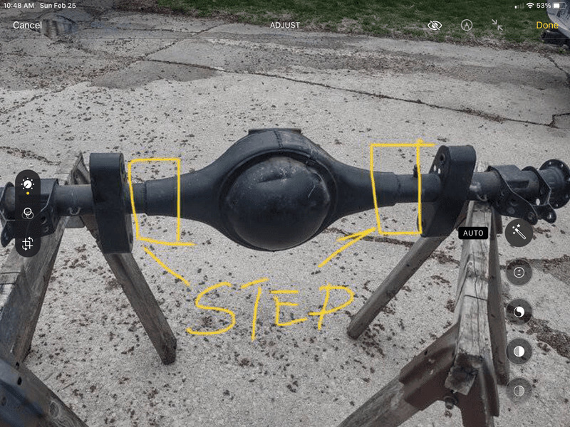

It has definitely been modified, the axles are early 60's axles that the hubs pressed onto. I ran that type of rear in a 64 Max Wedge 4 speed car years ago before swapping in a Dana from a 70's B body.
I don't see those housing ends and axles as a factory mopar passenger car. The factory tapered axles are smooth with a key way like a crank snout, then the threaded end. These axles have splines. Factory axle housing flanges have 5 holes for the brakes, these have 6 holes.
Look at the housing you can see a step down where they welded this stuff on.

Yup I knew it had been modified to some degree when I got it, if only the 4 link mounts and the splined axles. (Id thought those early ones were tapered like a big ball joint, haven't seen one in a while) I do know some tractor companies back then used the 8-3/4 but don't know what ratios.

i'm gonna guess that originally came out of a bigger truck or a tractor. the splined axle shafts are typical of smaller tractors like gravely, small massy and fords. the trucks-- larger ones, used the same style and with what looks to be way bigger than 3" tubes on the housing that would track.
my guess would be late 50's flat bed.
the pig is probably the only thing you'll be able to use. unless you got brakes with it. but mannn, those are gonna be heavy.
