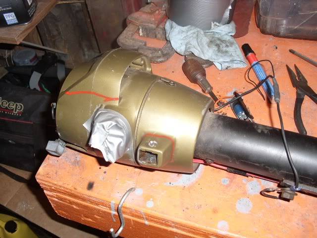

Next you will want to "mark out your plan of attack" lol.... take your paint marker and draw a rough estimate of where you will want to cut the indicator housing off at and where you will want to cut the shift lever off at.
You will need to drive the pin out of the shift arm in order to remove it.
Now take your cutoff wheel/grinding wheel and begin cutting on your lines...don't worry it does not have to be perfect.
