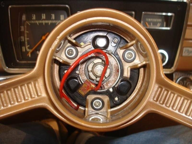

Step #2: Take a phillips screwdriver and remove the 3 screws that hold the horn button and spacer on, also pull the horn contact wire off. Don't lose the special plastic spacers for the screws!

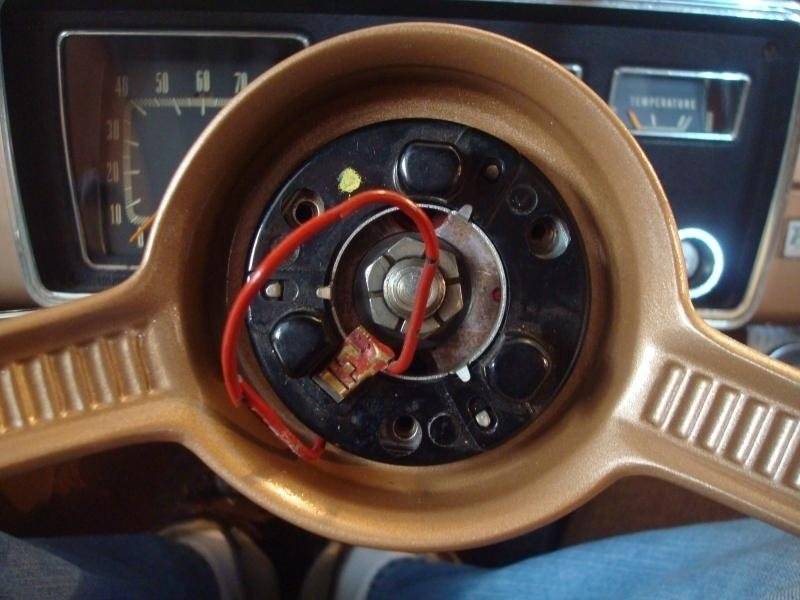

Step#3: Take a 1/2" drive ratchet and extension (long one works best) use a 3/4 socket to loosen the center nut. You will have to hold the steering wheel tight as you turn the nut loose.
