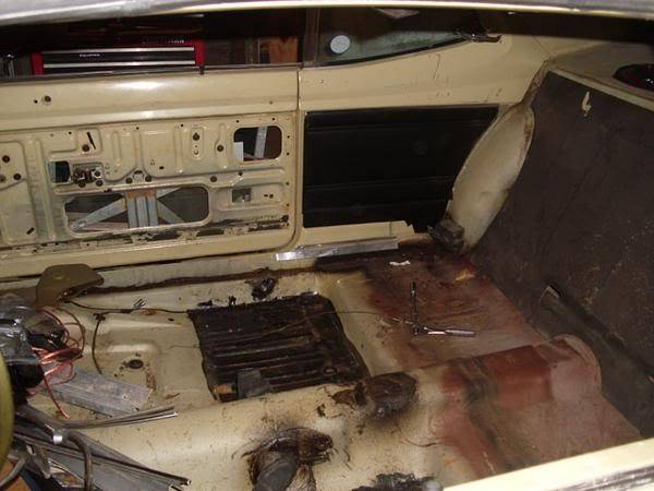

    about a year ago I stripped the floors down in my 72 duster with a wire wheel,grinder and sand paper until it was all bare metal. I then went through and primed the floor and then pained it black.
