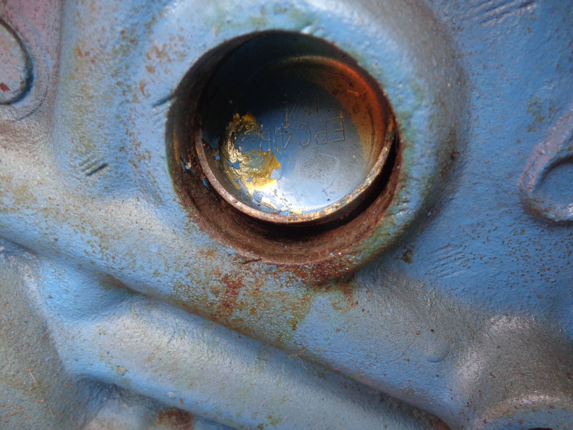

To remove the cup plugs use a large punch about 1/4" - 5/16" diameter and hammer it on one side of the plug to **** the plug... Don't worry if the plug falls into the water jacket, you can fish it out with a screwdriver and some pliers/vise grips... I like to use vise grips with the top of the tool to the block and grab the lip of the cup plug and use the top of the vise grips as a pivot to help pry the plug out of the hole...
Here's the punch end...
Now go to an edge of the cup plug and hammer it so it tilts/cocks sideways...
This one fell into the water jacket, so we will fish it out... First get it aligned with the hole using the punch or a screwdriver...
Then grab the lip of it with the vise grips with the top of the grips toward the block to use for leverage....
Pry it out as much as you can...
Now if it won't come out all the way and you run out of "leverage" you can use a flat blade screwdriver behind the vise grips to help give more leverage until you get the cup plug removed...
Here we got it out...
You can see some of the rust that came out with this one.... That is what we are trying to clean out before washing and then wash it out real good at a pressure car wash to get the rest out....
