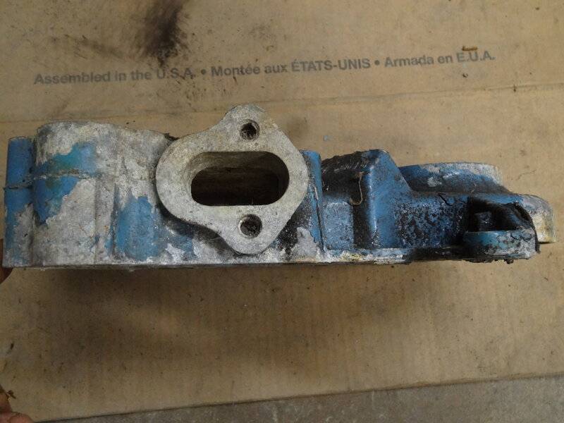

This is the fuel pump mounting flange...

The fuel pump mounting surface...

While you have the 3/8" x 16 coarse tap loaded in the tap wrench get these 2 fuel pump mounting holes...

Preparing the timing chain cover...
Once you decide what combination timing chain cover and water pump you are going to use, you will most likely have to clean up a used one... You may get one that is real cruddy, but don't worry they can be cleaned up to be like new...
