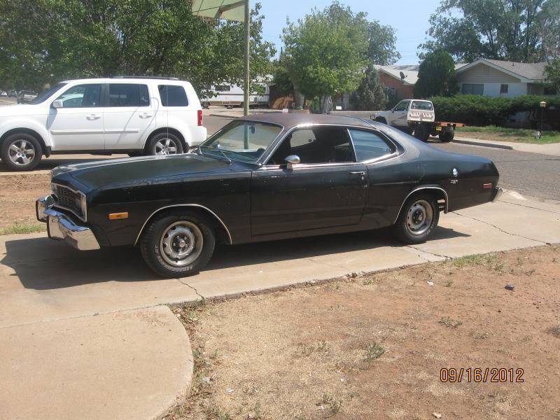

Sounds like fun right? Well, doing some work at home can really save you some money on your project. And we all like that. I recently did this job in my driveway and wanted to share the experience. The real Holdup on doing a job like this is: Tools and Seat Covers. I got the Seat Covers from Legendary Auto Interiors, and the quality is GREAT.
STEP ONE - put seat covers in sunlight to warm up
Position the car on the driveway but leave some working room in front.
Then, I always disconnect the battery
