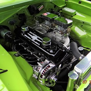

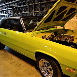

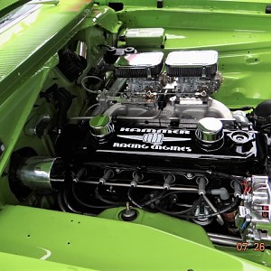

1973 Valiant>225 cu in bored-balanced-9:04 compression si1.770int valves?1.440ex valves-headers-cliford intake system-comp cam 478/502 engine dyno 210 hp-231 torque
Crystal & John Roush came in my shop 18 months ago and wanted to change there 6cyl to a v8-they were not into a lot of hp-i talked them into this combo everybody was very pleased with the finish product
