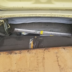

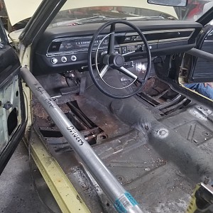

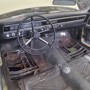

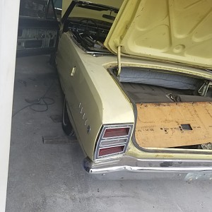

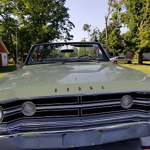

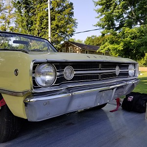

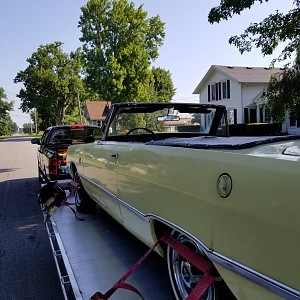

I'm doing a mini resto on this 68 Dart that I'm in love with. As with any resto, it's a work in progress, and a labor of love.

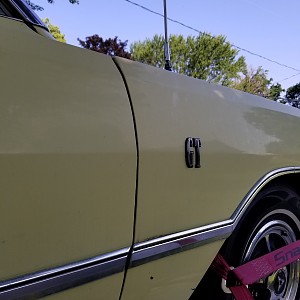

So my car: 1968 Dodge Dart GT Convertible. The fender tag is long gone, so many of the original details are unknown.
Seems to be the original SS-1 Yellow color, original 225 /6, 904 automatic

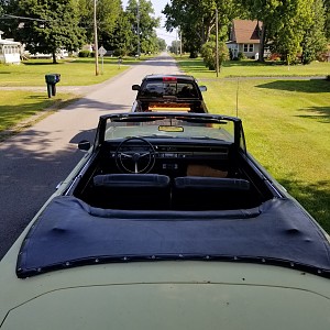

The undercarriage was super rusty, but the body and interior were in decent shape. All the trim is present and in good shape. Convertible top looks new.

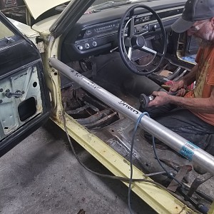

The plan for restoration: Getting new frame rails, perch mounts, and anything else needed to make it structurally safe. New floors (removing all the...
