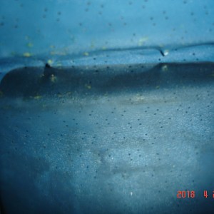

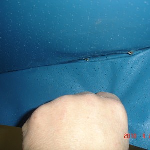

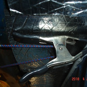

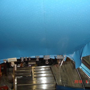

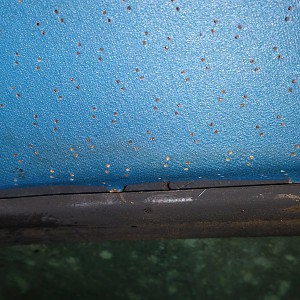

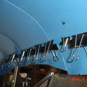

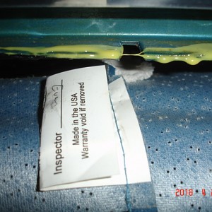

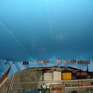

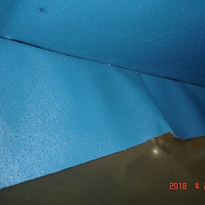

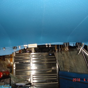

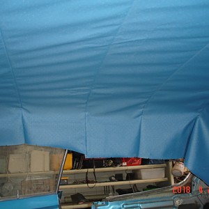

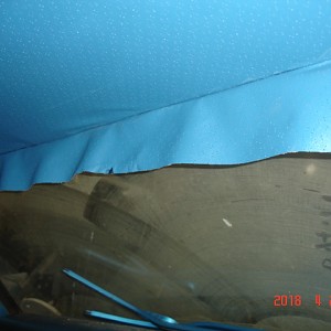

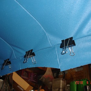

tools I made and items I used//the technique with the putty knife was to roll the headliner into the gasket then kinda pry down forcing the headliner against the TEETH locking it in with sparingly using 3m adhesive // now let dry// trim and let the gasket relax.
