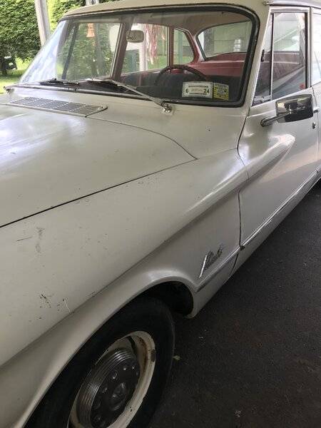

Hi everyone-
I got a 1960 Plymouth Valiant 200.
Where can I get the tool to remove the inside door handle and window crank clips?
