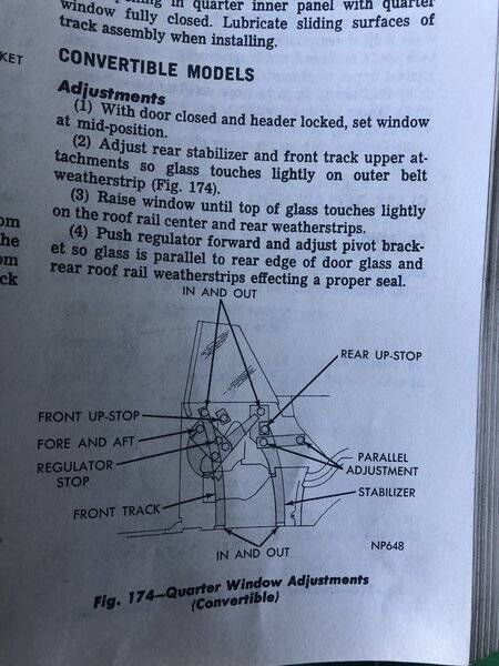

Glad you finally got them in. For future reference for anyone here is what I found in the 68 factory service manual
Thanks. Pretty much the same as the 67 and 69 instructions. They leave a lot to be desired.
