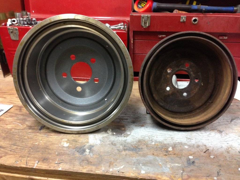

Just for comparison sakes... Here's a pic of the original 10" next to the 11x 2.5 replacements.
The car now stops like someone tied it on !!

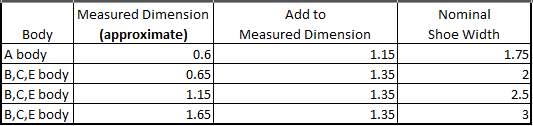

Here are 2 methods of measuring to be sure you get what you are expecting.
(The values do not need to be exact, there is enough difference in each measured value that it will be evident)
Method #1
[FOR SALE] - 10 inch drum backing plates
B, C, E body 5x4.5
1 1/2"
=11 x 2
1 3/4"
= 10 or 11 x 2 1/2
2"
= 11 x 3
A Body
1 5/16"
= 10x 1.75
How you measure.
Hang the backing plate off a table so the e brake cable mount does not raise the plate up
Method #2
(Dimensions from a Hotrod (IIRC) article)
How to measure
measure as in the photo and add 1.15 for A body and 1.35 for B, C, E body

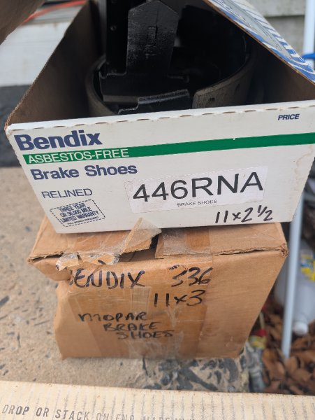

i believe that these new drums are 11x2.5. can anyone confirm that part number? I'm having trouble finding it.
i also received 11x2.5 shoes and a set of 11x3 shoes.
I'll go with the 11x2 5 since i have the backing plates and now have the shoes. just need wheel cyl and I'll put new hardware in them.
