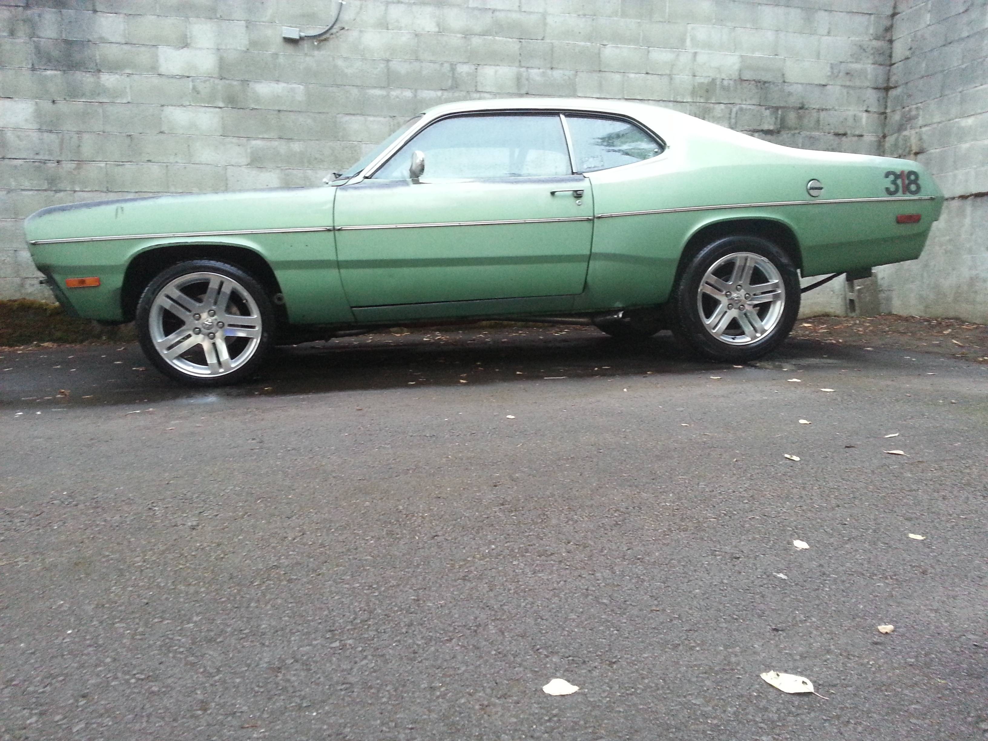

I use a set of 2005 magnum 18" rims on my 73 duster. On the rear the stock rims and tires fit but I have a little bit wider the normal a body axle so that the deeply in set rims don't come in and touch the leaf springs which could be a problem with a stock with rear axle it may need a little bit of spacing. as stated the front need a smaller Tire and either a three-quarter inch spacer or have the center of the rim bugged out because the old style hub is deeper and bigger, but the bolt pattern is the same.

Well personally I just got one hell of a deal getting the rims and 90% tires for $200. I just couldn't pass it up and was very happy to see the back rims and tires went on with no problem and I just went to a used tire shop and bought a nice set of tires that would fit under the front and actually what I did was got some 5 on 4 & a half to 5 on 4 & a half adopters for the front instead of trying to space them out with long lug nuts or hog out the rims which is something I may do in the future actually. How about that for one big long sentence?
