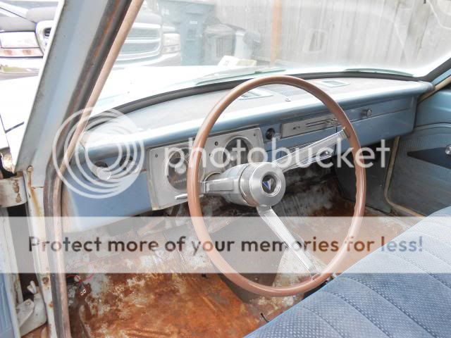

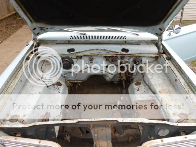

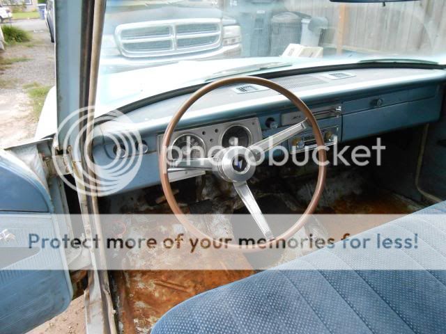

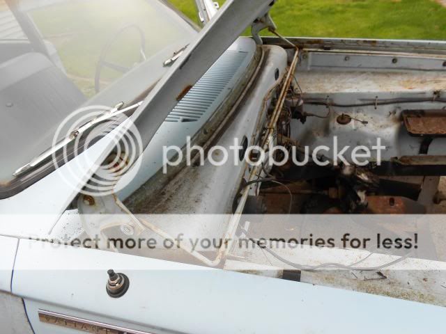

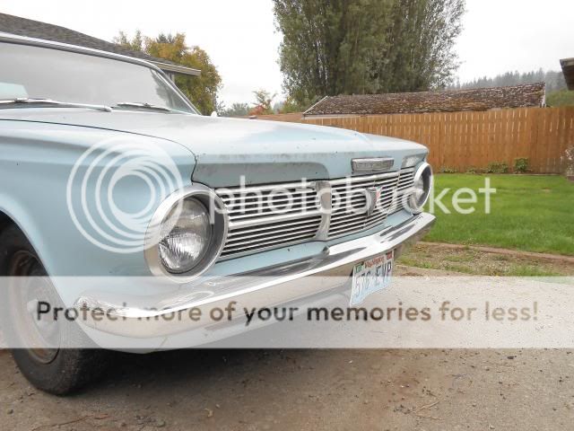

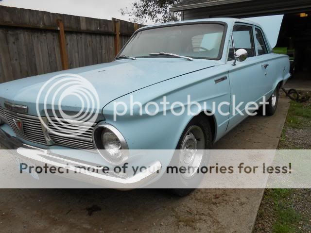

well guys. the time has come to start my build thread for my 64 1/2 valiant. her name is Valerie. We call her a 64 1/2 because she is wearing a 64 fender on one side and a 65 on the other. she is a very confused lady. ha ha ha. I purchased this car with the intent of doing a very tight budget build. I am in the process of putting a 360 magnum motor in with a 904 and 8 3/4 with 3:31 rear gears. its going to be a fun cruiser and daily driver that me and my lady will share. it will eventually become the "spare" bracket car. plan to take it with us to the track when i run my dart. the wife, family, friends can all run it at the track. should be a **** load of fun. the car was a factory column shift manual /6 car. the previous owner started a 360 4-speed swap and health issues forced the sell. he kept motor/trans and all 4 speed gear, including the trans hump. here she is pretty much like i bought her.
I havnt got a whole lot done yet but i did get some cleaning up done and started the trans tunnel patch. I have floor pans on the way. they should be here this week some time.

better look at title that's a 65..... good luck on you build bone head
It shouldn't be much of an ordeal to find a correct 65 left front fender.....then your car will be back to it's original birthyear!

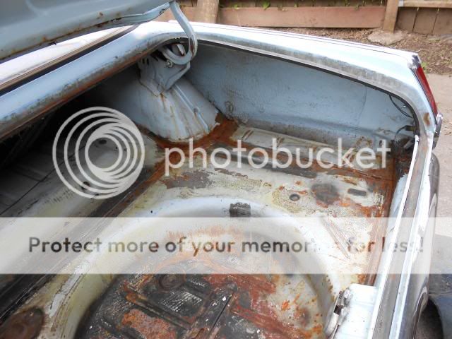

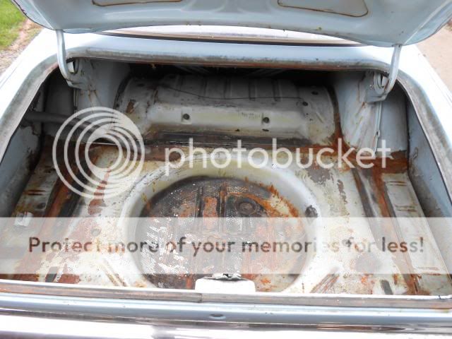

that would require paint. lol. the car is super solid and straight. I dont plan to paint it any time soon. gonna run it how you see it. I just plan to fix the rust in the passenger compartment and the trunk. the trunk is only surface rust under the factory seam sealer. the trunk will be sprayed with truck bed liner.

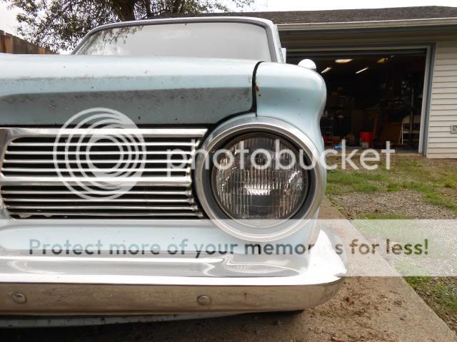

That would just mean you'd have to find one in light blue! It's gonna be a cool car. It IS in nice condition and those headlight rings are amazing!! Hard to believe the contrast in the before and after on those door panels too. It will be fun to watch your build progress.

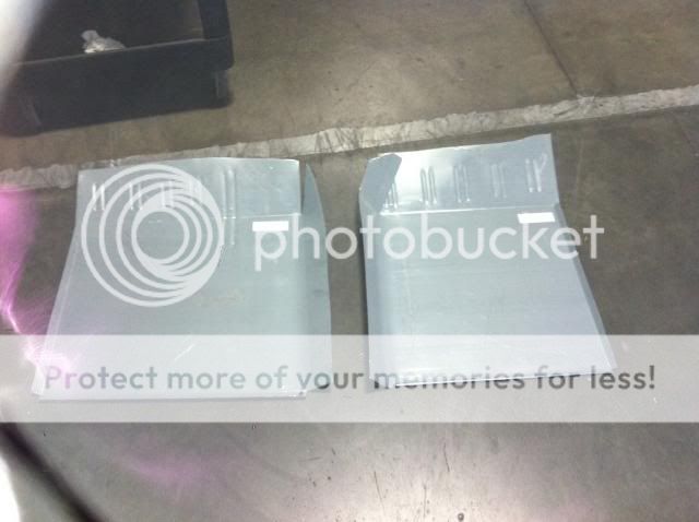

got the new front floor pans in the mail today! gonna get em in this weekend! not the best quality i have ever seen but its slim pickings. got these from andy's. they were $155 for the pair shipped.
