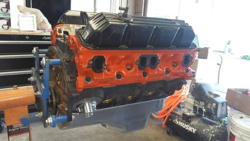

Well thanks to 75slant6 I was able to get the right pan this weekend. I was able to finish up the bottom end as well as get the new roller lifters in. Now all I have to do is finish my manifold. :eek: (don't worry I'll drop the push rods in before I button up the top end)

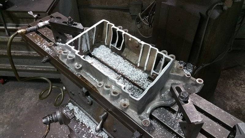

I was able to get some time in on the bridge port this weekend and mill/plane the manifold flat I ended up taking alittle more that 3/8" off the manifold. So when all is said and done the highest point of the motor will be 10.750" (throttle body) from the dizzy deck. Making it more than possible for all of this beast to fit under the hood with out issue. I have available 12.5" inches of room at the moment. :thumbsup:

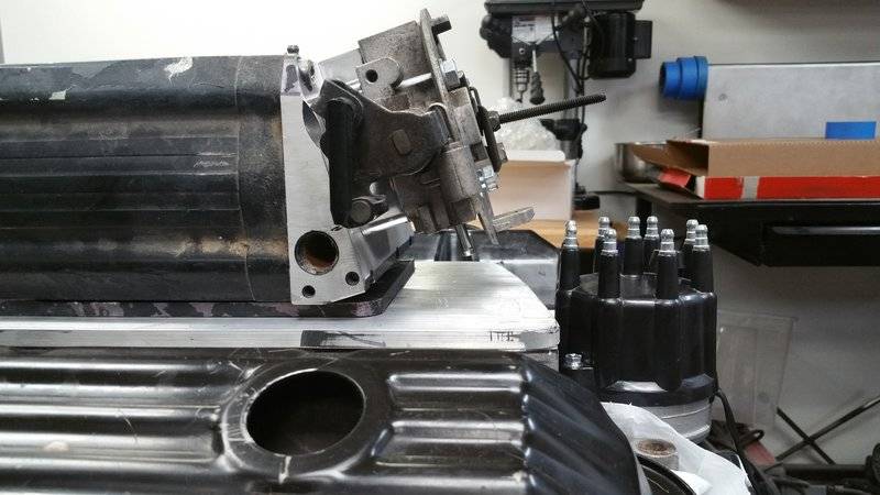

Cut my manifold top plate down to a usable size and it's dead on. Did some more Mock up work this time fitted the distributor looking for clearance issues and I look like I'm in the clear. Thinking of changing the throttle body hat to a turbo crab hat to kick it out to either side for the cold air and filter. Got measurements for the top plate and for the supercharger adapter plate. Looks like all we need to do now is weld everything up. Then cut the intake holes. Looking to have this manifold finished before the end of the month. I'm going to have to source a larger set of injectors for this and a 3 bar map censor. (I'll get with Ryan on those) But so far soo good. Everything seems to be coming together, slow but I'm seeing progress. As soon as i'm finished with this motor I'll be bringing in the car to the garage and tear it apart. first up for that will be Disc brakes up front and lower pan modification with OD trans fitment. After all that I have some frame stiffening work I'll need to do with the addition of a triangulated 4 link rear end.

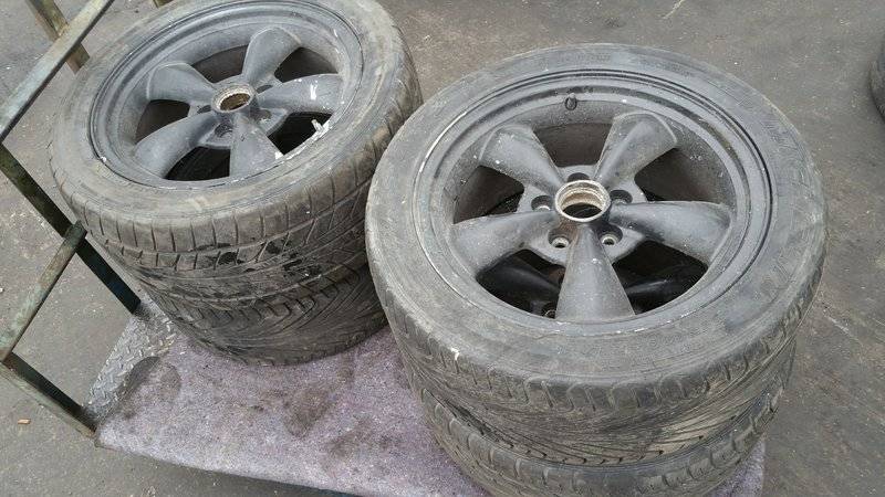

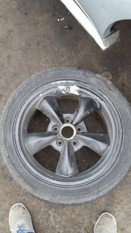

Had a nice find this weekend while at the yard. Came a cross a f-upped convert mustang and found a set of wheels under it. Got them for $188.

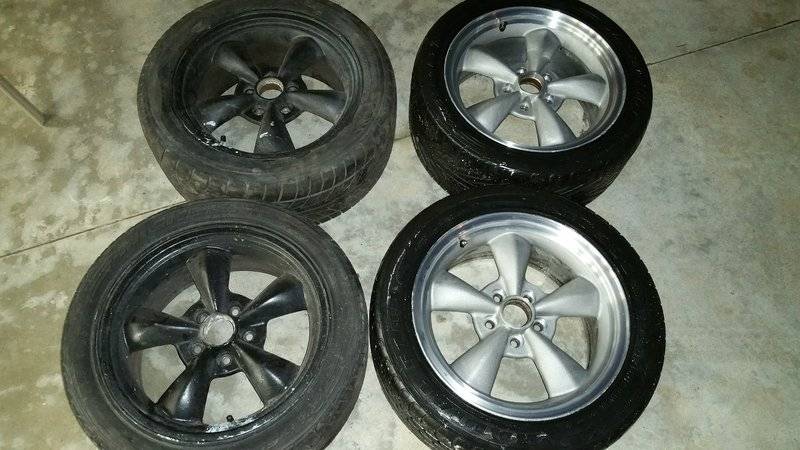

On the way home from the yard I stopped an grabbed some paint stripper hoping to salvage the wheels. Turns out they had been painted with house paint. First with white then black over that...
Thankfully I was able to remove all the paint to reveal a set of unfinished aluminum. These will look so nice on my build...

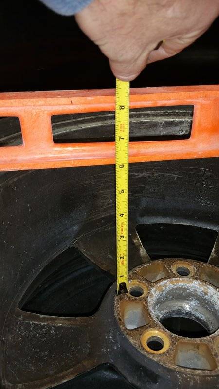

Okay so I was out taking measurements to order the spacers needed to fit the wheels to the Barracuda turns out I need 3/4 or 20mm spacers. Not a problem, parts ordered and should have them tomorrow. But while under there something billet and shinny (compared to the rest of the dirty undercarriage) caught my eye...?

So I finally was able to get the right thickness spacers for the rear of the Barracuda to fit my new wheels with 255/40r17
tires which now fit so damn well... I ended up needing a 1.5" spacer. I'll post pictures of the fitment later.

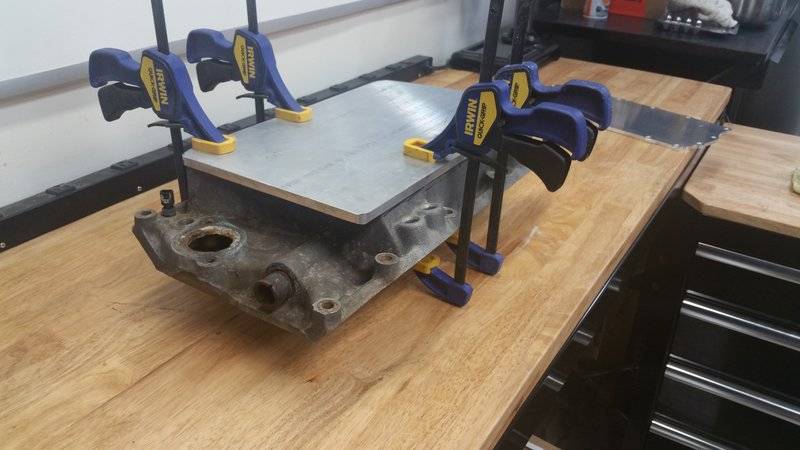

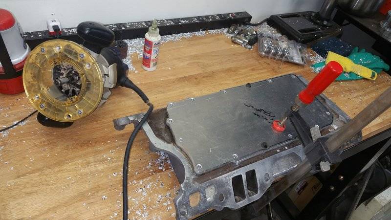

I was able to find the needed router bit to clean up my belly plate for my manifold. This was the first time I have tried this with a wood router and it worked fabulously. I will be doing this more in the future for sure...
I also have to do another cut to my top plate before welding ugh... slowly getting there...

Got the top plate setup for the last cut before weld. I have to cut the edge back by a 16th to and 8th of an inch so i can get a corner weld for the plate to the manifold. Stronger weld than a butt weld. Ran out of time tonight so I'll cut tomorrow and hopefully have the first plate welded next week.
