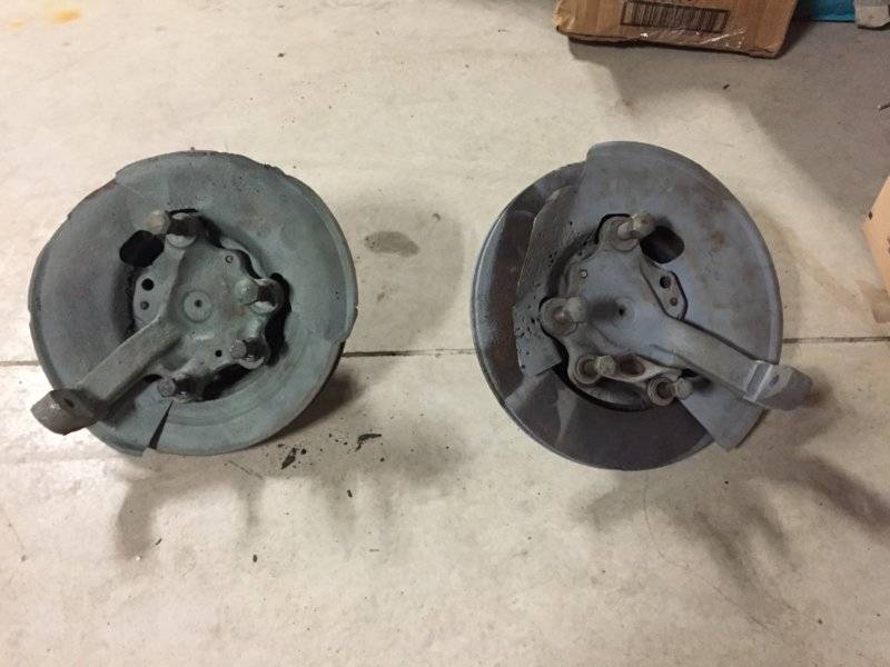

Hello, what donor vehicles will provide the needed parts to convert my Dart to disk brakes in the front ?
Now that depends. If you want to retain the small bolt circle, any 66-72 A body with the Kelsey-Hayes 4 piston brakes will work. If you are thinking of going to the large bolt design, any 73 and later A body with disc brakes will provide the needed parts. With either choice, make sure you get every component including all of the hardware and fasteners, distribution blocks, and hoses. If you’re sourcing 73 and later brakes, make sure you get the upper control arms as well, you’ll need the larger ball joint for the disc spindle, ditto with the lower ball joint for the K-H brakes.

It will probably be hard to find a complete set from a donor vehicle but im on it .
a local non-member has these,not sure what he's askin but can follow up if you want
Oh, you would be surprised what you can find. This car has K-H on it, also had an 8 3/4” SG rear, the recall steering wheel, 150 speedo in the dash, and most of the hard to find trim in the trunk. For the $1650 I paid, I’m already about $1k ahead, and still have a ton of stuff to remove from it!
