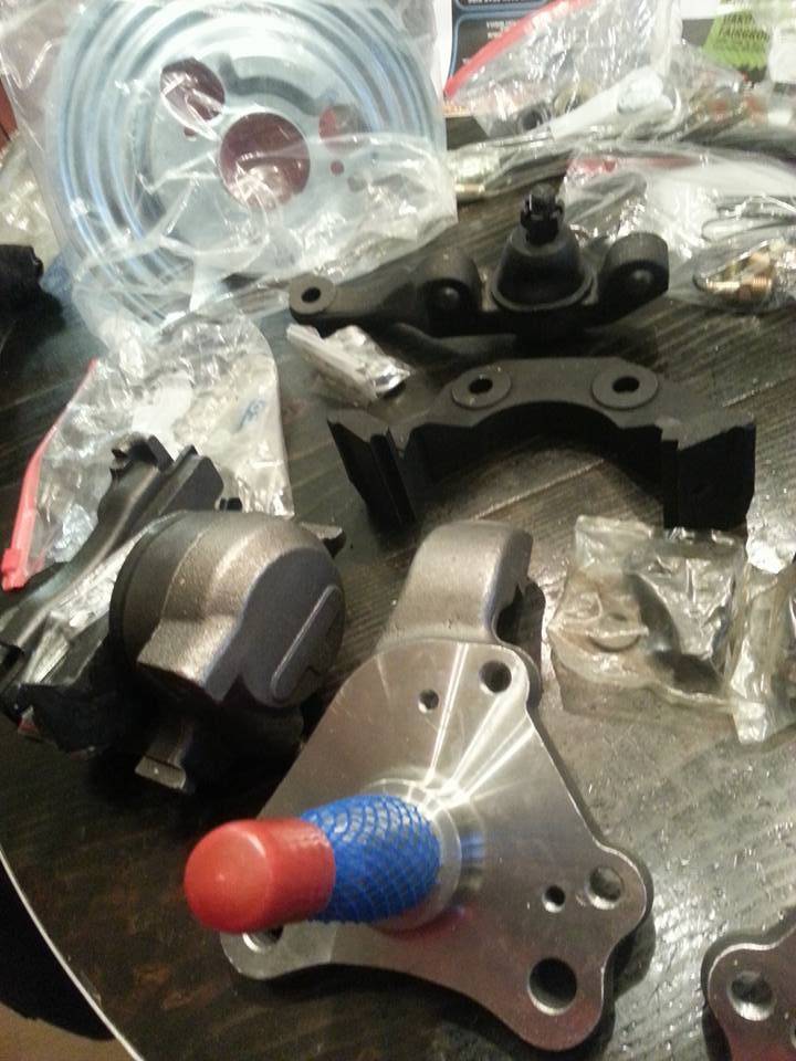

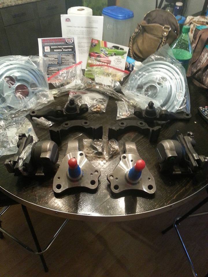

But first she needs an update on the brakes. So I went to the Ram Man and enjoyed a little telephone time and watching his Video's on youtub and seen a bunch of advantages to staying all MoPar with his set up that was ready to install on my early 66 Plymouth Valiant.
Thanks Ram man :thumbsup: this kit simply went right back on by it's self for me and my friend with a lift and a strong set of shoulders :thankyou:

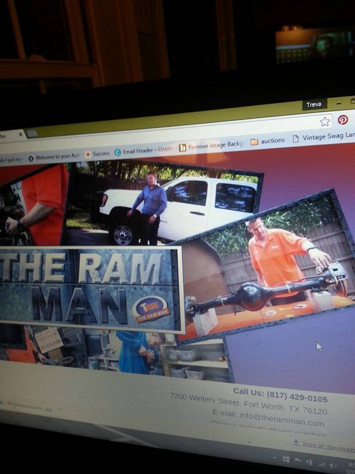

does ram man sell the kits ??
I went to his site and there are only videos, nothing for sale ???
how much was the Brake kit and where did you get it??
Oh yes ! search Mopar Brake kits on ebay and you will see all his stuff, he is all so big on Truck brake updates and in the videos you seen he should have said his web site. He is very strong on American built parts and a hoot to talk to.
Here you go, I must say he knows his stuff and as you can see in my pictures I posted his parts are ready to bolt in

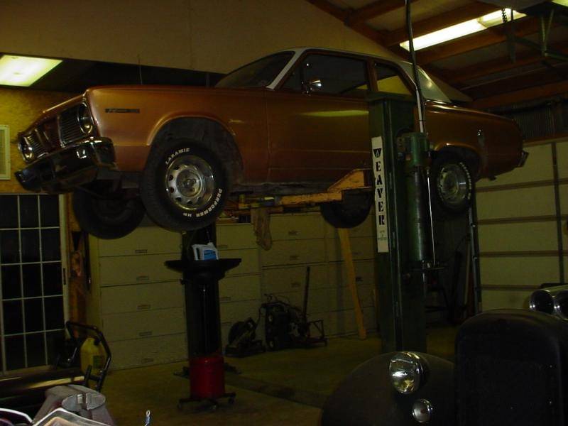

It was a long wait to have my turn on the lift but that day did finely come for me

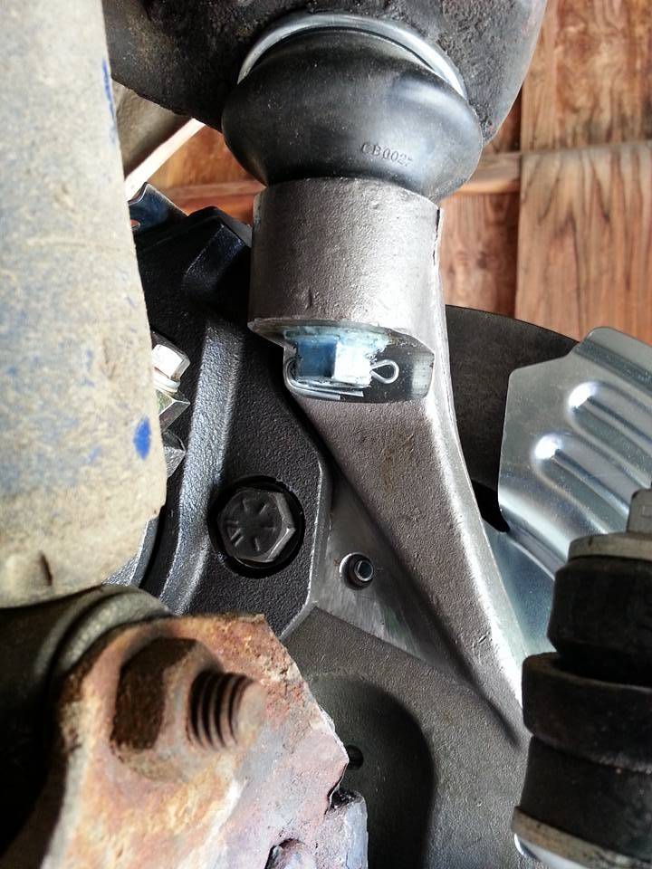

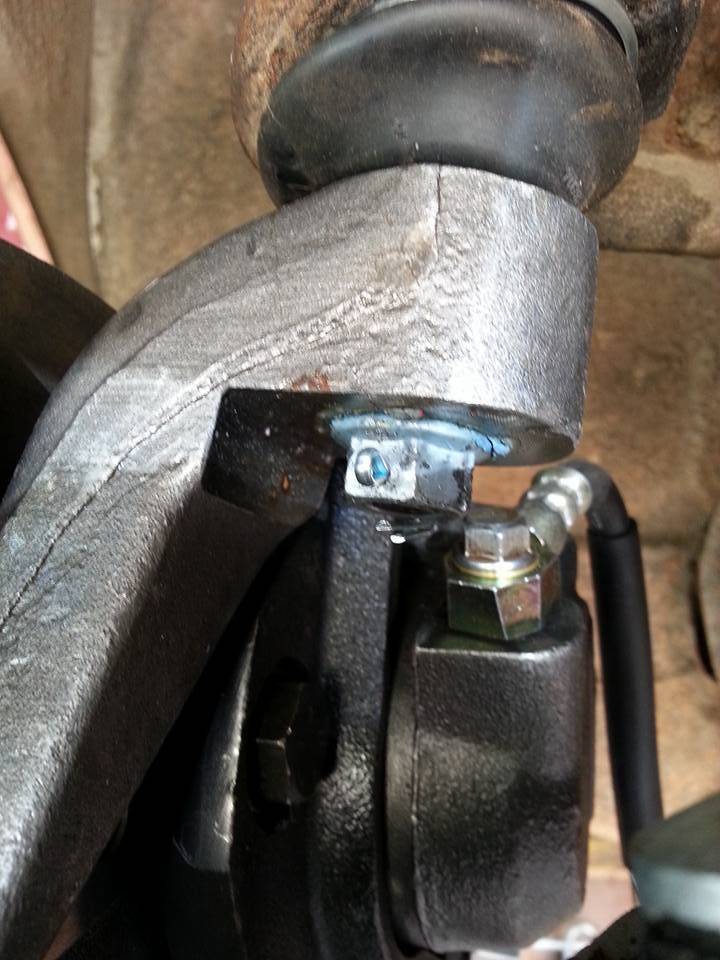

as far as those brakes go.. i don't see any threads sticking out or cotter pin in that upper ball joint. is there a set screw or something instead? i prefer the larger ball joint myself so i bought new upper arms when i did jamies dart.. guess the small ball joint with a sleeve will work though.. should stop a ton better thats for sure..
v8 will make the car a lot more fun.. you will love it..
I took that problem and did this Joe, I feel the need to have a cotter pin and it was way to easy sir
yea i'd prefer a cotter pin too.. i'm sure it has enough thread engagement but man it looks funny....
he makes a D100 kit too that the spindle nut has no threads sticking out and uses a set screw i believe. . between that and the $1800 price tag i decided to go scarebird. one of these days i'll get around to putting it the kit on the truck.

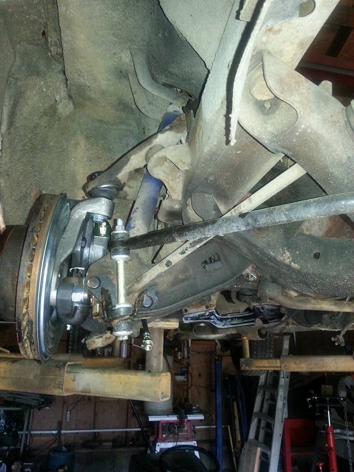

I like that you are going with a sway bar.... :steering:
The front sway bar and nice newer rear springs we put on a year or so ago sure woke her up in the turns and I don't need air shocks anymore krazykuda

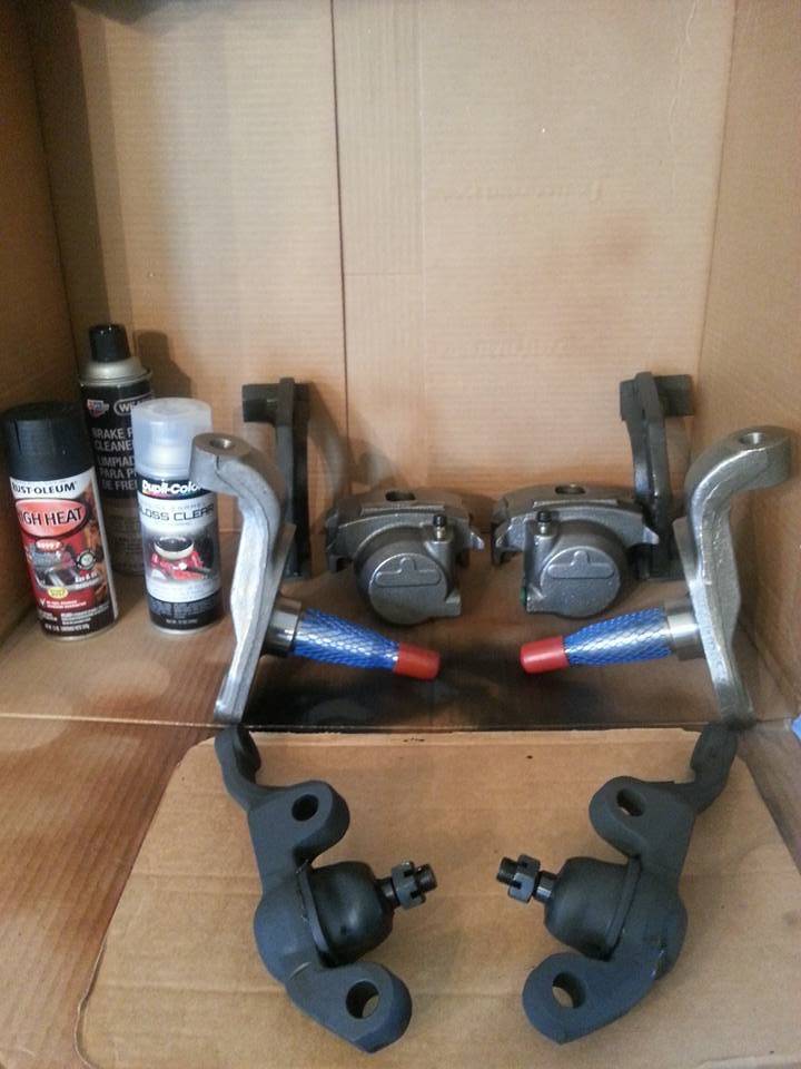

I forgot to say that when I received this great kit from @theramman.com the first thing I did was clear coat some parts and blacked the ones I wanted to, to keep them looking fresh under Victoria as my update moves forward.
