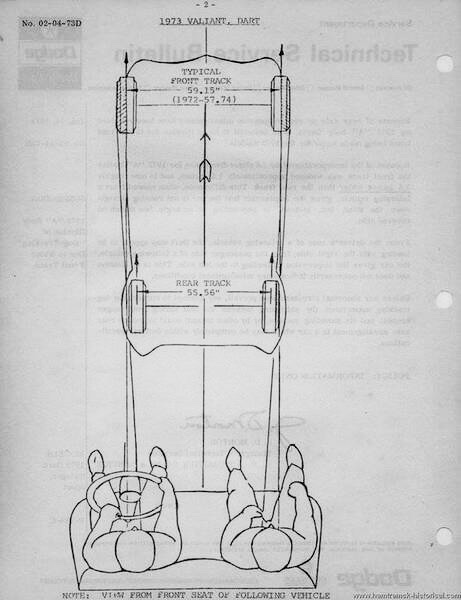

Once again you have not done the conversion and don't know what the hell you are talking about! Physically LOOK at any 73-up A-Body with factory disc brakes and the track difference it very noticeable! My only mistake is that it is 1-1/2" total, not 1-1/2" per side, so 3/4" difference per side. It has been known since 1973. Our own Professor Fate talked about it in a 2020 post...
I have a complete 73 K frame and disc in my 72 Dart. I have been running 225/60R15 up front as shown in the pic. I just switched to a 235/60R15 but haven't drove it yet or even set it back down on the ground plus I want to go a little lower so we'll see.
The difference in track is 1.5" overall.
It was a factory TSB, 57.74” to 59.15”. So, 1.41” overall per the factory. They’d probably know.
