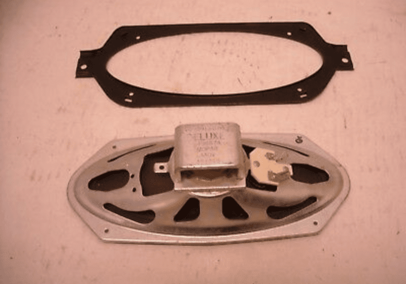

The speaker is a "deep" 10x4"
There are 4 screws that attach it to a grill that attaches to the dash with 2 screws.
Remove the 2 screws and it will come out. Might help to remove the defroster vent tubes.

Howdy, sort-of-a-neighbor. I've done this upgrade a couple of times. My 66 Valiant had some kind of oddball speaker (like a 5x8 or something?) that was shot. As the PO had installed a modern DIN radio, I added a pair of 4" speakers that I mounted in a piece of 1/2" plywood I made to fit the hole in the dash and the mounting holes. Here's what it looks like.
I also just upgraded the tunes in my 72 Coronet wagon. I used a different bracket than the one listed in post #4, but the concept is the same. It took a pair of 3.5" speakers.
I used one of the Retrosound 4x10 dual voice coil speakers in the dash of my truck to go with a modern DIN radio also installed by a PO. It's surprisingly good.

I made my own speaker bracket by tracking the original speaker. I think I was able to mount two 4" round speaerkers, but they may have been 3.5". I think they were Infinitys. For a head unit, I used a round marine guage pod radio in a homemade console. Radio is about the same size as my tach that still isn't connected.
