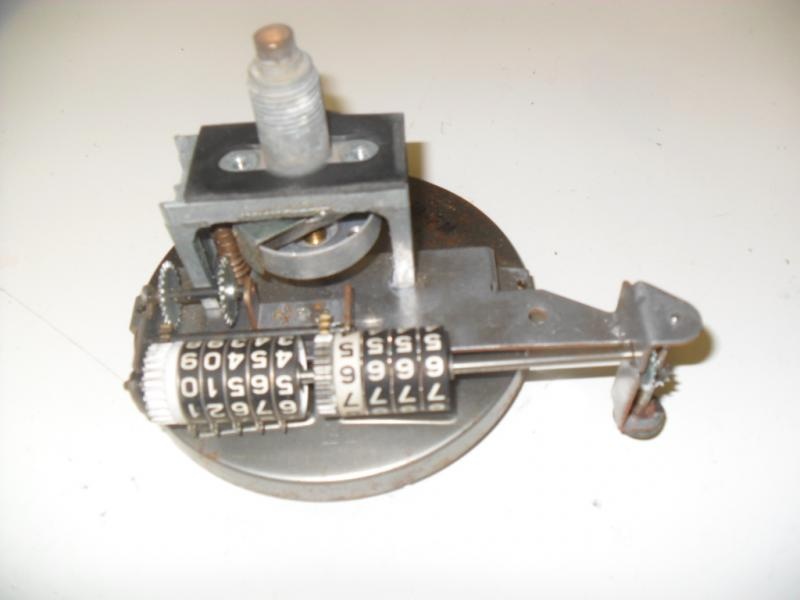

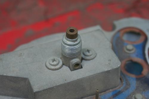

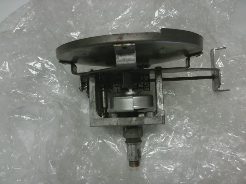

This is what the 68 and up cable's ends look like:
Here's the back of a 68 speedo:
attachment.php
Here's the back of a 67 Speedo
attachment.php
attachment.php
Installed in the car no one will ever realize or know if it's a screw on or push no connector. Just get what fits your speedo.
