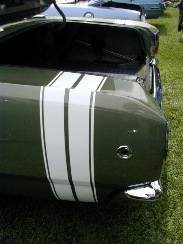

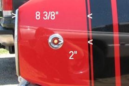

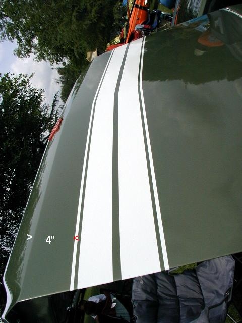

Absolutely. I had mine painted in and put under the clear coat. I didn't want to use a decal as wax tends to build up along the edges making the cleaning even more... entertaining. Here's some pic's, showing the shape (yes, there is shape to them. They kink in the middle or the trunk.) and location. Look closely at the pic's as they have the measurements in them for the spacing to and from objects and body lines.
The green GTS was my guinea pig for the placement of where things go and what they should be. The red car is mine. Note the angle of the stripe is just a bit off in the pic. The 2" away from the marker is correct, my body guy blew the 8 3/8" part by not squaring it off the edge of the quarter at the tail lamp bezel. You don't notice it tooooo much and at the time I was so enamored with the out come, I didn't notice either.
For the stripe, I took and used a Micrometer on another car's stripe, since it was an original decal, to get the widths and spacing. .250" (stripe color), .250" (body color), 2 3/4" (stripe color), .625" (body color), 2 3/4" (stripe color), .250" (body color), .250" (stripe color). Take these measurements and put them onto paper in the order I gave and you'll see the strip come out on paper and have a template to verify on a "living" car should you desire. I got real lucky being allowed to use a sharp metal instrument (micrometer) on/near a nice car's paint. Not every body will let someone they don't know do that.
Happy Striping

I thought it'd be nice to show you a full side view pic so you can get an idea of what it looks like done. This is fresh from the body shop, during reassembly, a couple years ago.

So the stripe should be squared to the taillight? Mine is a 67 with no marker lights do you have any other measurements?
The stripe is 4" from the first bend as shown in previous post. Make sure you point the stripe in the right direction which will be toward the rear of the car, its hard to see from the back but easy to see from the side. The stripe on the yellow car is not correct and was painted on by the PO.
