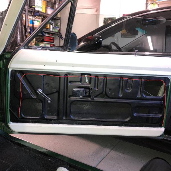

Does anyone know what type of adhesive should be used to glue clear plastic to the upper portion of the interior door panel to keep moisture out? I seem to remember it was some type of black tarry stuff that the plastic stuck to but could be removed and re-stuck back on. The bottom part tucks into the bottom part of the door in the long slot.

The top three sides were originally a white strip caulk. The bottom edge, to ensure that it remained tucked in the slot, was a long strip of 2" black tape.
There are numours brands of caulk rope. I would look for one with a high temp of about 140 deg F

I purchased the calk strip from DTM on eBay
And
a roll of Morlite from Amazon.
To my eye they are the same product.
The top is the Morlite
The bottom is the DMT
The Morlite is significantly cheaper
