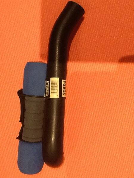

So I am getting close to putting the engine back in the car and breaking it in. I have an issue with the upper radiator hose. I ordered one that said "without A/C" as we have no AC. I got a hose that looks like it would work, but instead of a 90 bend into the thermostat housing, its a 45 bend. The old one is long gone, but it was a universal bendy one. The one I have now is a Continental 60666.
So either the hose is wrong or the thermostat housing is wrong. For a 1969 Dart with a 340, what is correct? For what its worth, the "with A/C" hoses have a 90 bend from what I can tell from the pictures.

I think the hose I got is defective... see the attached photo. I have already contacted the vendor and they are sending me a new one.
Gates 20594 for the upper with straight up water neck

My situation is the first. So the attachment to the radiator looks correct, but then it just arcs gradually down. Looks like either will work, but I am hoping that the replacement one I am getting will be defect free.
Rock Auto Shows the Continental 60666 and it looks like the correct hose for non A/C.
The Gates 20594 is the correct hose for non A/C but it never appears on any part catalog. Only the A/C hose appears and it's listed as non A/C.
You can only find it on the Gates catalog if you use the cross reference using the Mopar upper hose part number 2863211
@lemondana Well, the tag says it is. So either the tag is wrong or the hose is defective. Either way, they are sending a replacement for free.

So I got my replacement hose. Same defective crap. Not even close to correct. Says its a Continental 60666, just like the first one.
I'm gonna try the Gates 20594 here locally and see if that is any better.
So I went to pick up the Gates 20594 today... same story. It looks exactly like the defective Continental 60666.
So now what? Where can I find a good hose?
Sounds like you've been getting a good hosin'! Did you try 20602 at the local store?
