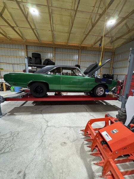

I finally put the LED lights on the lift yesterday. I'm pretty happy with them. They seem like good quality, and they're magnetic, which is nice. It makes a big difference.:thumbsup:

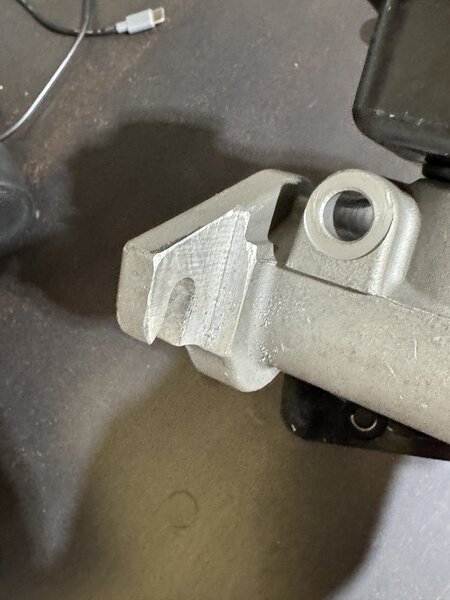

Moving forward, I do not want to deal with the same MC issue. I ordered the relo bracket from Mancini and a different MC. With the new setup, modifications still needed to be done to clear everything.
-The studs to mount the MC had to be pressed out, and the holes tapped to receive new 1/2 bolts.
-The passenger side bolt hole needed to be cut out so I could rotate the MC onto the bolt, then tighten it up.
-Shave down the front of the hole to gain more clearance.
-Shave the bolt head itself down to gain more clearance.
The result is:

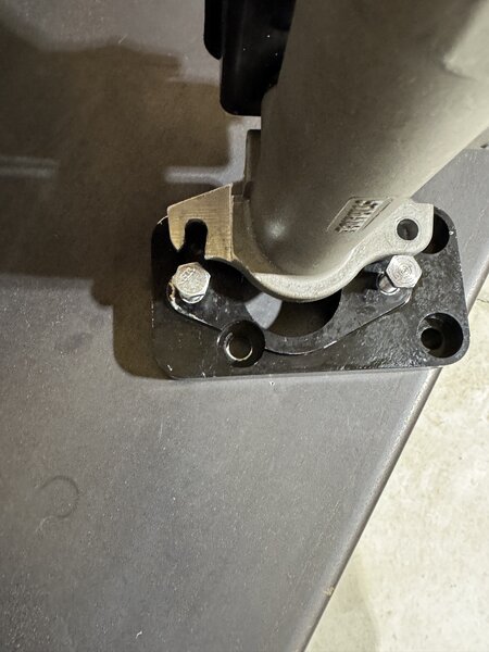

-The relo bracket can bolt up to the firewall
-Install valve cover.
-passenger side screw is already installed in the relo bracket and then backed out to accept the master to pivot onto the bolt.
-Install driver-side bolt.

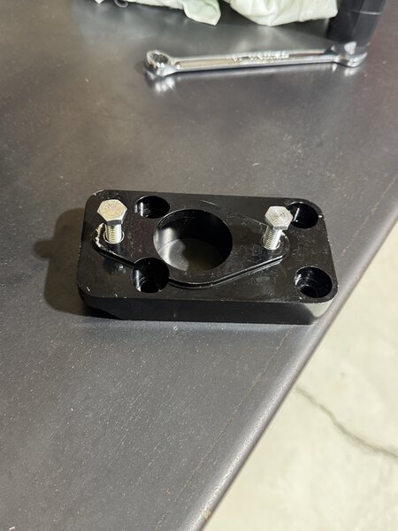

Mancini Bracket before mods
for the oversized cast valve covers required for the Stage V / FHO Hemi heads, we ended up making a custom HDK offset M/C adapter with added offset for clearance and ease of removal.
OEM stamped covers, no problem with the standard aftermarket offset.
The result is:
