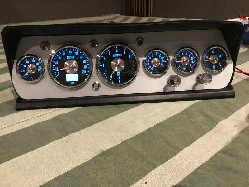

Good Evening All,
I have a question about the Classic Industries part (MA18011A) in the title. I have never noticed until now that the description states:
"Will fit 1970-76 A-Body models with original square speedometer (some early models came with a rectangular speedometer and this panel is too narrow and will not fit)."
I have a 1971 Dodge Demon that originally included the gauge panel attached. Is this considered the square speedometer or the rectangular speedometer? I am unfamiliar with any other speedometer than this for the Demons, and technically this is a a rectangle. So will the Classic Industries 6-Gauge unit fit my '71 Demon?
Thanks In Advance,
Jacoby S. Berry
Only guessing here as your right both are rectangular. I thinking they are calling yours square. Call them and see if you can send them a picture so you are both on the same page.
By definition they were all rectangles. Square would be equal lengths on all 4. Their ad should probably say 72-76. 70-71 dash was different.
Good Evening ALL,
so I just got off the phone with Classic Industries, and I was told that my original speedometer that I posted is indeed considered the RECTANGULAR speedometer. Apparently there was a "limited production" of actual SQUARE speedometers for Late '70 to Early '71 A-Bodies, and Chrysler made a transition to what is the more common and dominant rectangular speedometer configuration (what we typically see above) for Non-Rallye cars. I asked if there was a picture available for the SQUARE speedometer as I have never seen one, and of course the representative was not able to provide one. So essentially what Classic Industries offres only fits a limited number of cars with a configuration that I have never seen. I'm sure it's possible to mod it to fit, but I'm just not sure what amount of labor would even be required.

I think you must have confused him. The picture you showed above matches the image they show on their website -
The only other dash and IP I know of is the Rallye dash that came in the 340 cars and all A-Body Barracuda.
It had a much longer IP opening that the one above:
If you posted your actual IP, then the Classic Industries insert will fit the opening.

I have that IP installed in my Duster, everything fit perfectly. My factory dash was the same as yours.
I bought the panel from Autometer. I got it on ebay from a bout $220, and then put my own gauges in it. I wish they were a little fancier looking though.
I'm pretty sure my original IP is the same as yours. But as an FYI, that panel can be found for $215-250ish and standard sized gauges fit in case you wanted a different style than what they offered as a package. Painless Wiring sells a gauge wiring kit, but I'm not sure if the layout fits that panel, I built my own. Also, I noticed in the notes, that is an electronic speedometer, not a mechanical one, so you'd have to buy the adapter for your trans to make it electrical which is another $100
SPEED SENSOR, MECH TO ELEC, GM & CHRYSLER, 7/8
