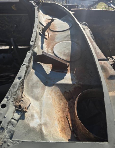

On today's episode of what the hell is Big J working on is Cowl repairs. I test fitted the good used cowl section and got the center trimmed in and tacted down. Still a little more trimming left, but I'm going slow at it and moving around so it doesn't warp. Stay tuned
On today's episode of what the hell is Big J working on is a continuation of last weekend's cowl repairs/install. Last weekend cowl was trimmed and tacted in.. This morning I finished welding in the seam and ground it down smooth. I also added a skim coat of filler. Stay tuned
