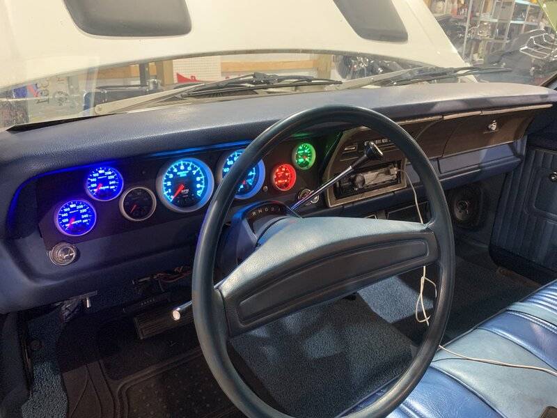

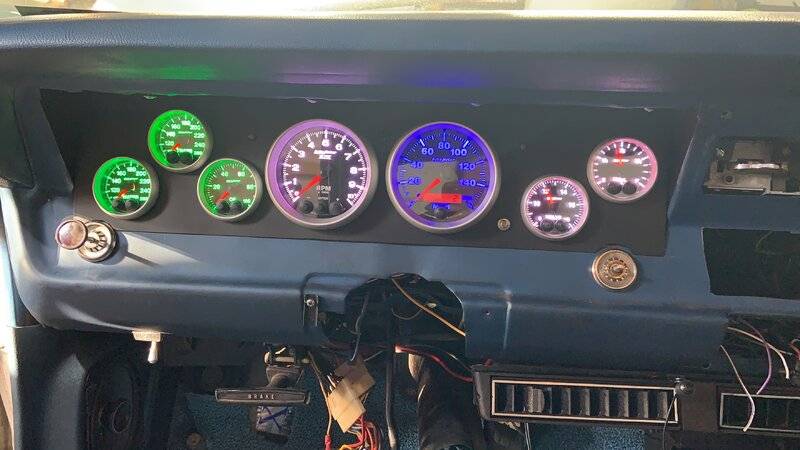

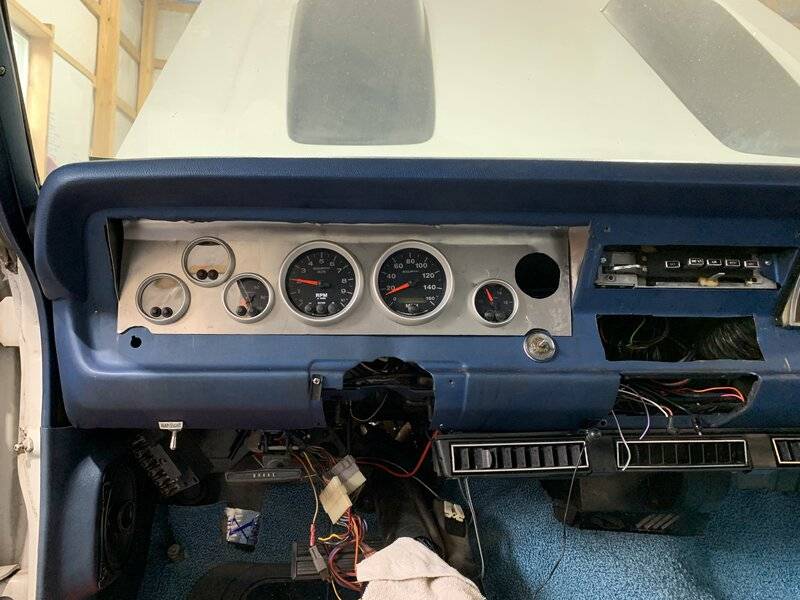

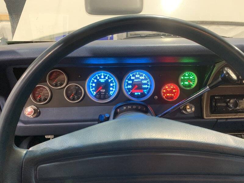

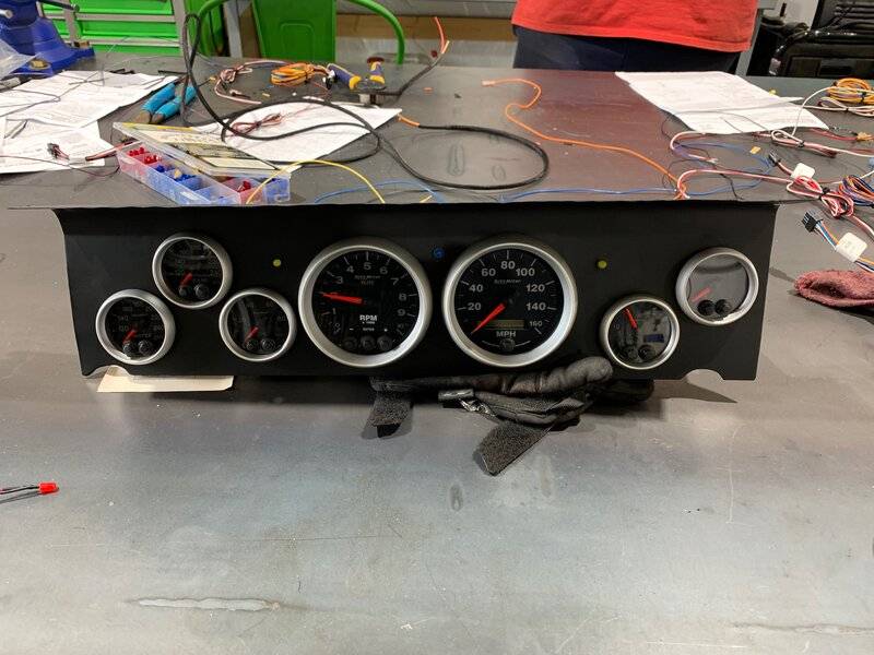

The wife and I fabricated a dash for my 71 Swinger. Was a tedious process but let me get all the gauges I wanted into the stock opening.

So have I. I was hoodwinked by classic catalog to buy their insert. not even close to fitting. And nothing out there to buy that will fit a 71 Dart Swinger. SO, I believe that charger426 has the answer. Build your own. After all I have a thousand bucks worth of Autometer gauges that need to go somewhere. Thats Hot Rodding?! As he said, tedious but not impossible.
Nice work and a good guide for building mine for a 71 Swinger. Might I inquire what material did you use and the thickness? Also maybe a template laying around? If not OK but a new cottage industry is waiting to be born. I have got a lot of info from this forum and was finally man enough to join. Thanks to everyone for the help!
