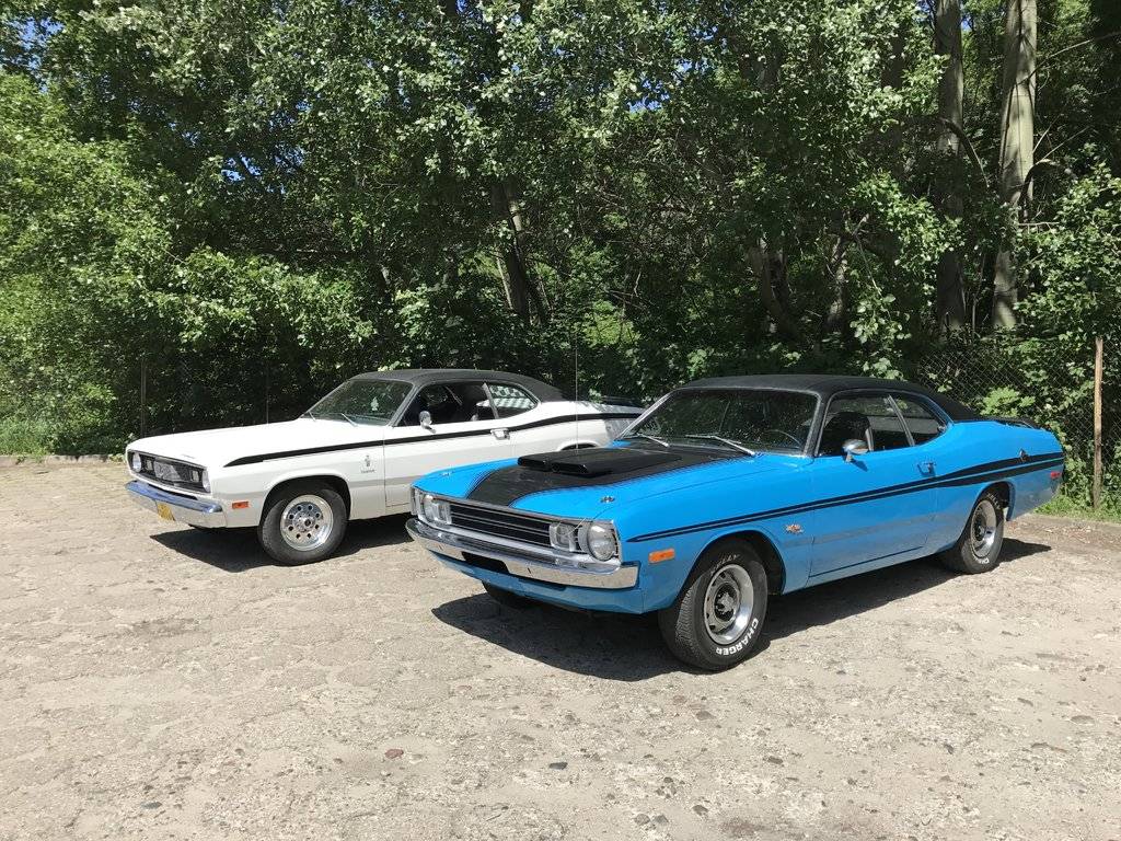

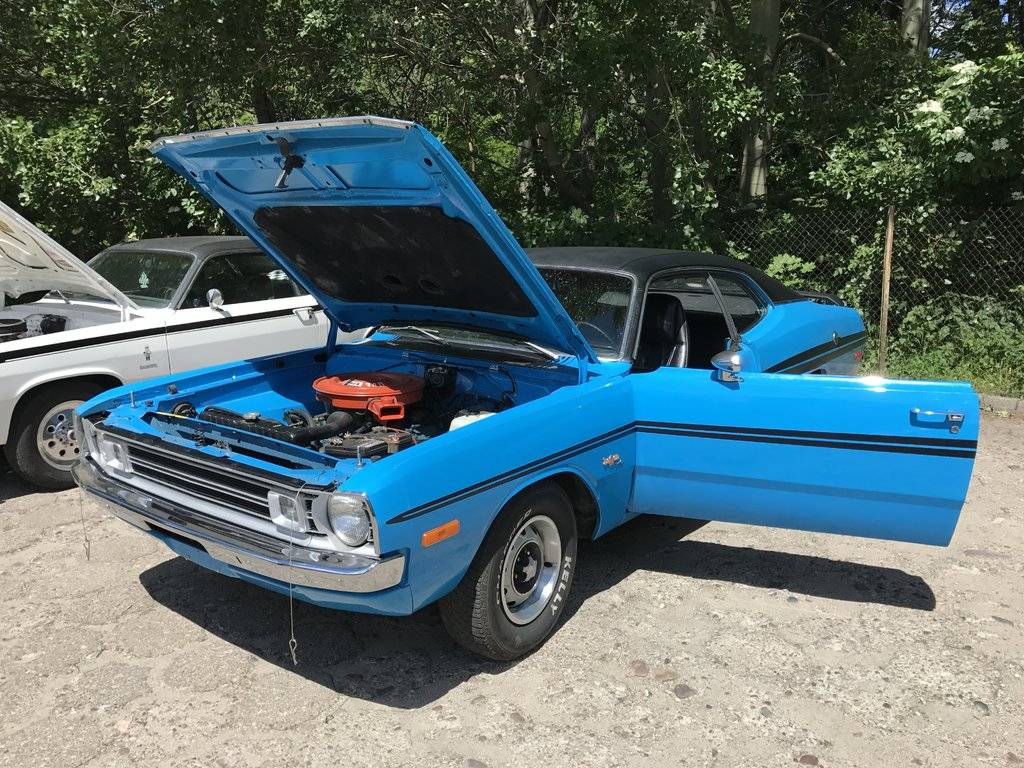

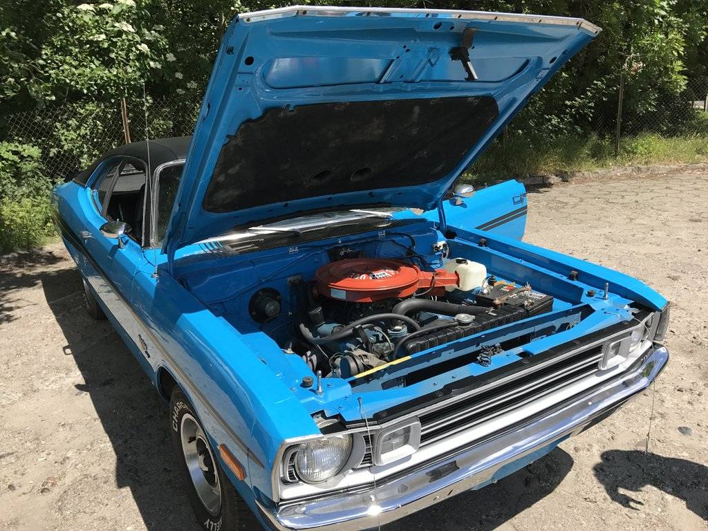

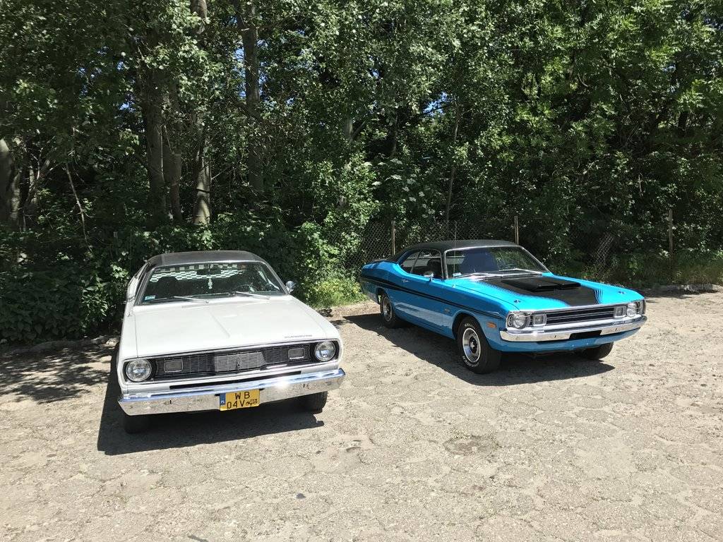

              Here are some photos taken today. You can see my Duster there too.
              I checked the balancer and this car has forged crank for sure so it's not that terrible aferall.
