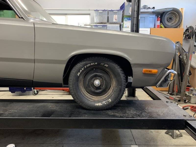

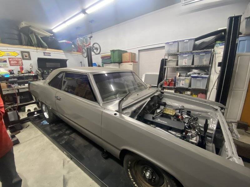

      This is the current stance. 495B977D-DF11-4D8C-997E-62DA54D53DBE.jpeg DA9F111D-8D34-4582-BE5A-216B95720DD0.jpeg

      looks like you need to crank up on the torsion bars a little
      there are a couple of guys who are really good with tire and wheel info on here @72bluNblu comes to mind
      FWIW, I think you can get a 25" or 26" tire under the front

        Yes the torsion bars are all the way backed off as I have to remove the right to clear header a bit. Left is out already

                          Ah ok. Thing is that's with a 14" rim. When you go the 15" rim if you stay with the 24" tall tire the sidewall proportion looks kinda weird, it makes the wheel look smaller. If you like how that wheel looks then keeping the proportion about the same would mean going to a 25" tall tire, so the 215/60/15 would be a pretty similar look.
                          • Thanks! Thanks! x 1

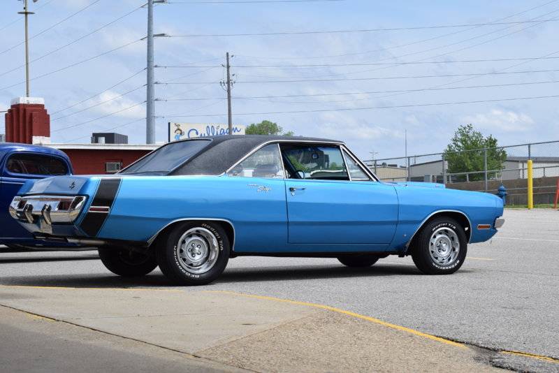

                            Not the best photo but...

                              In the photo above, the front wheels are 15 X 7" and have 0 offset. The rear wheels are 15 X 7" with +6mm offset. The front tires are 195/65R15 (25" tall) and the rears are 235/60R15 (26.1" tall) M/T drag radials.
                              Good luck and please post what you decide.
