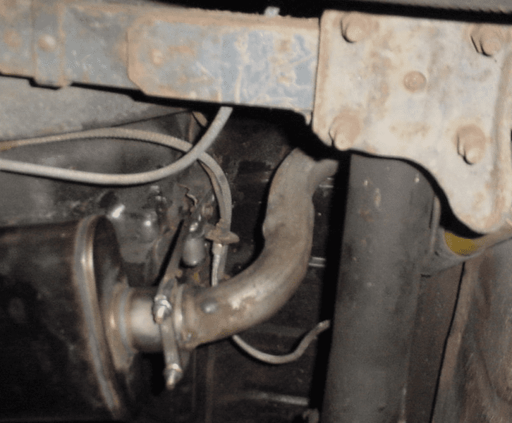

In concept I'm fine with pipe diameter reductions after the muffler. The exhaust gas has cooled considerably by that point, and it would be good to keep velocity up all the way to the exit. However, in reality it depends how its done. That's why these tailpipes are coming off in the next week or so. I'm going to test a mandrel bent 2.5" tail pipe and see how it fits. I may end up splicing in some 2.25" straight pipe. Since your car is a '68, you should have less trouble with the tailpipe fitting than a '67. If you have a local shop that can make or weld up the bends, that's the cat's meow.
This gives some idea of reduction in size and turn combination that is just not going to allow for good flow. Even at mid and low rpms its probably hurts velocity.
Driver Side is worse.
