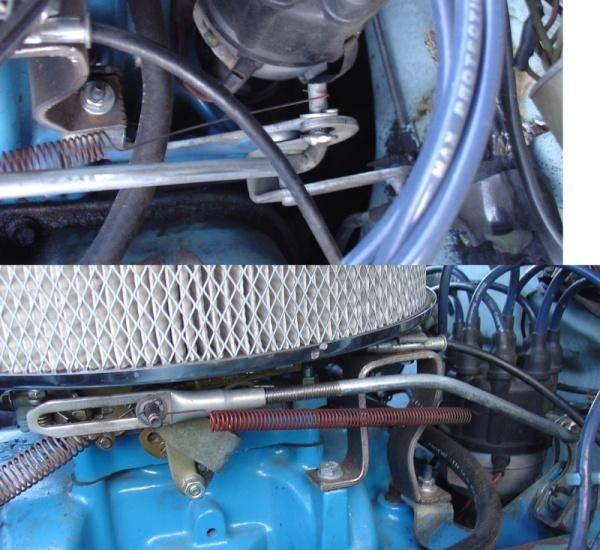

I bent and threaded a piece of 5/16" round stock for the longer rod. The difference in height to get a straight pull for the throttle cable was compensated for with some 3/16" flat stock bent with a bench vise, torch and hammer. It's not pretty, but it works until I get around to something better.

You gotta do what works!I also modified my throttle linkage for a 4bbl. on the slant 6.Now it,s gone and I have a 360,Thermoquad on an aftermarket intake,so I,ve got to modify a new throttle bracket again.I,m useing lokar kickdown cable and a B&M floor shifter witha cable,this is in a 66 Dart(tight squeeze)

I hammered out the bend in the kickdown rod and I think it might work now. It goes most of the way back and will only go back further at WOT if I push on it really hard. Should work for now until I can either make something from scratch or buy the proper linkage.
