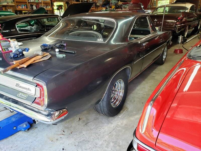

1968 Barracuda Convertible with Nitto 275/60-R15's on 8" rims. They don't rub. Not too many drag radials available in 275/65-R15 on Summit's site.
How about M/T ET Street S/S P295/55-R15's on an 8" wide rim? These are the avatar's street tires.
Thought I had better pics of these street tires/rims but most of the pics I have are with the slicks on it.

I have 295 60 d15 hoosiers on a 68 barracuda ,not tubbed , fenders rolled ,3/4'' offset spring hangars , front leading edge moved even to inner fender panel < stock contour .
I`m on a chrome book and cant post pics , look at my Avatar pic , those are 295 65 15 drag radials , which didn`t hook up for me ...
I refuse to move the rear axle back , which puts less weight on the rear end of the car , I have enough traction problems the way it is .
We moved the axle forward on the old hemi belvedere which did help a small amount , 341002-003 springs on a b body ...

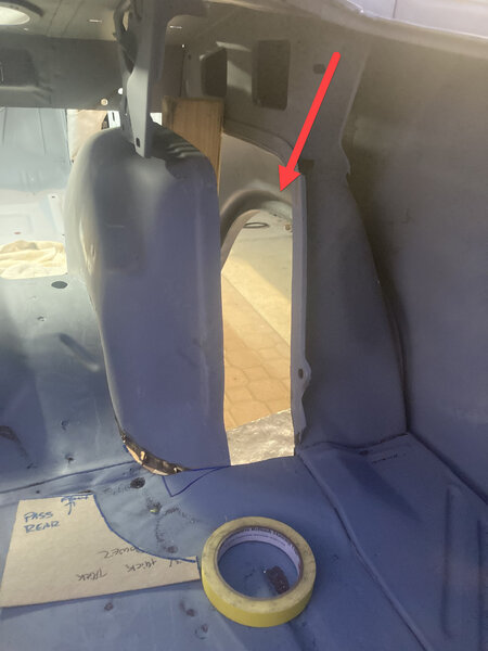

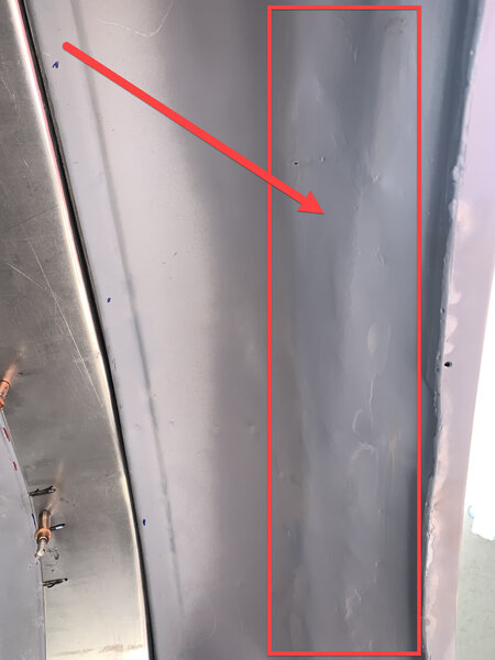

When you guys are mini tubing, are you flattening out the lump in the outer wheel well?
That will rub if rear is low or tire is tall. Should give you some more room.
This is @ns1rm21's latest project
Before
After
