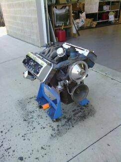

I'm considering buying a 318 poly to put in my 64 Barracuda, along with an A727 trans. I know the heads are a bit larger, but I'm hoping there's room. Any headaches or horror stories to report?
With out a doubt it would be neat.....but alot of work and way more money.

My thanks to everyone for their insight and comments. After reading all the great advice, I tend to agree with the majority, that it would be more work than its worth. I do like the "coolness" of the poly motor and how it can be built to the moon, but this Cuda doesn't need 500 HP. Maybe my next Project! I have a mildly built 273 and just need to find an 18 spline 904 for it. I'll try that first. Thanks again.
I have that trans for you up in Michigan, near Ann Arbor.
It's not whether a Poly is a worthwhile engine, and it will probably fit with some hammering and modification. Just like a 727 in a early A. It will fit with some hammering and modification. A few have done it before. If the OP has to ask, he probably shouldn't attempt it. If you have to ask, it's probably above your head. It just doesn't make good sense. If you like the Poly (I think they are cool too) you would be better off finding a early 60's B body. The poly's came in those. They fit.
