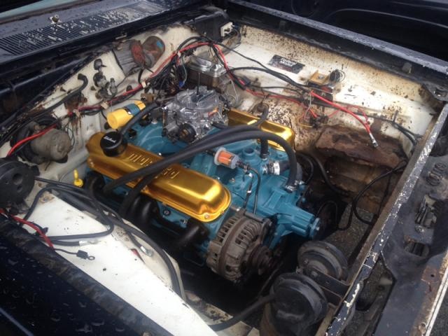

My 340....72 block, 70 crank and rods...had the rotating assembly balanced....best money spent...she runs so smooth :glasses7:
This is a post April 72 340...cast crank, 645 floated rods, KB pistons...balanced with no issues with aftermarket counterweighted balancer, B&M flex plate...runs smooth as silk
I too have built cast crank motors with no vibrations. Nothing wrong with a cast crank. Key is to have assembly balanced with balancer and flex plate as txstang84 did.
