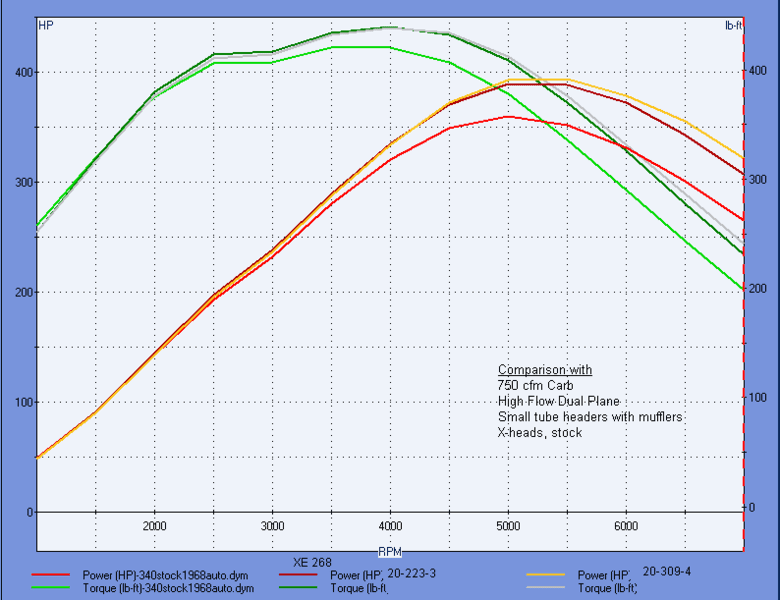

Thanks Toolman.... some of the numbers are funny like that old Dyno Derby 340 with a XE268H, stock heads popping 390+ hp... sure it does... Not a fricken real world chance it runs anywhere close to those numbers at the track! Maybe with a 50 shot of juice! :lol:
The programmer's must start with stock specs. I ran my 273 and it came up within a couple ponies of the 235 horse spec. If you guess on the rest of the combo It's exactly that. A guess.
