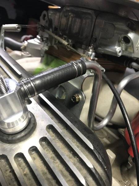

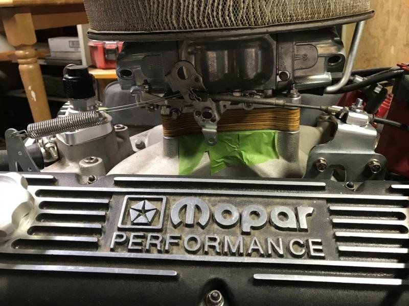

Having a hard time finding the right part I need so figured I'd run it by you all as it has to be a common problem.
The stock throttle bracket is too short for the intake manifold I am running and it is causing the throttle cable to hit the linkage on the carburetor, it looks like I need a throttle bracket that is 1-2" taller but I'm not finding the right parts from Lokar, etc.
Any recommendations on making this work?
Thanks

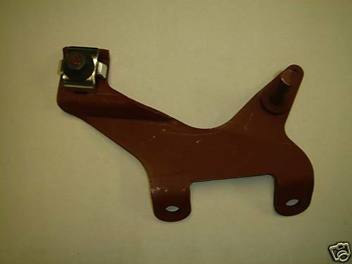

I get all that stuff from Andy F at AREngineering. He makes taller throttle brackets for taller manifolds.
Here is his bracket and throttle return spring on my small block with a Victor 340 manifold.

Didn't mention if original intake or Make, TO RUN THE TALL DUALS OR SINGLE PLANE THE TALLER BRACKET is here. You might need the one I have.
manciniracing.com

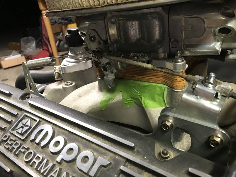

Here is what I did on my 67 B-Cuda with 273, and an AFB, when I in stalled an LD4B intake. I just welded in an 1 inch extension. It works fine with all stock linkage.
Remove the bracket, and cut the top part off, and weld in what ever highth you need.
Dave

I just used the original one and bolted an extension using the original stud and tacked a bolt through the extension and moved the clamp plate up to the new stud on the extension.
