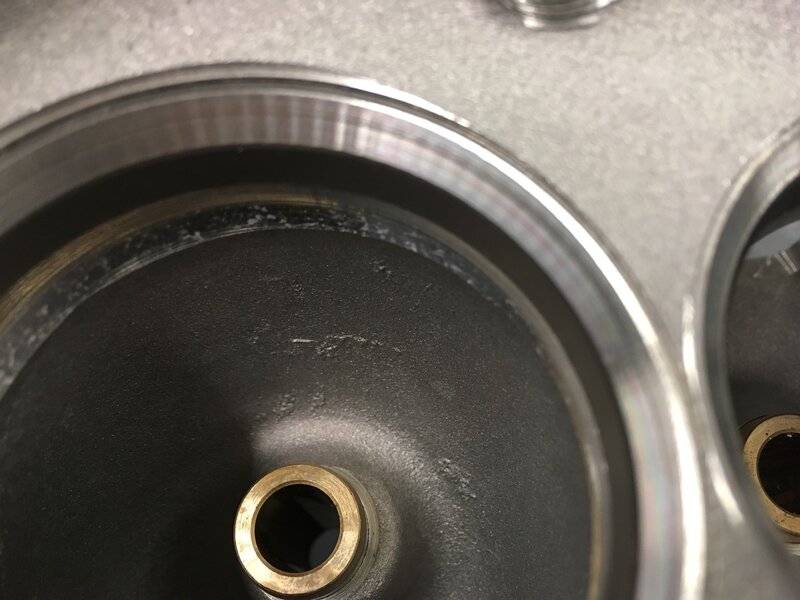

I’d rather save the 300 and do my own valve job.
It’s the stuff like this that you gotta watch out for...... and without inspecting them, you wouldn’t know if you had some like this or not.
This is a fresh ootb SM BBM head.
No...... they’re not all this way...... but..... some are.
You’re gonna have a hard time “buffing that out” with lapping compound.
Chattered
