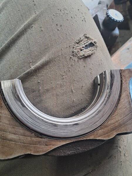

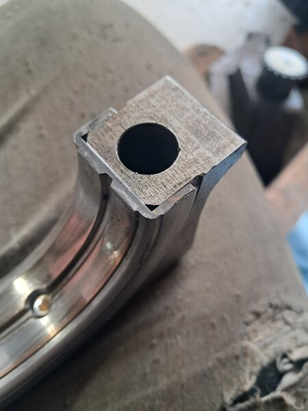

Have mild 360 magnum .030 over, smallish roller cam mated to 727 hughes 3000 stall and trans go TF2 I believe shift kit. The issue I'm having is I believe the trans/converter is pushing on crankshaft has thrust bearing worn out and crank is wore now as well. Started hearing light ticking last fall right before winter hibernation now had it around block couple of times and it's got worse. So pulled pan off and checked it out found bad crank and thrust surfaces. Will a torque converter fail and start pushing against crankshaft? I can walk crank back and forth with pry bar probably 1/8 inch or better. Hughes torque converter and trans is probably 6ish years old been behind a couple different engines didn't have a problem with prior engine.
