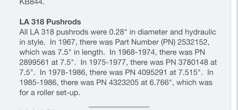

I recently purchased a pretty nice street worthy 73 Dodge Dart Sport. Used to own a couple back in my teens. I started to repair a head gasket leak but instead decide to pull the engine to to do a paint job which has now turned into a complete engine overhaul thus opening up the dreaded can of worms. I know nothing about this engine other than its a 72 360 which I believe is pretty standard. It has had replacement CAM with hydraulic lifters however its a mystery to the exact make or model. Upon taking it apart I found one of the pushrods slightly bent. What I thought was going to be a easy fix has now turned into a search and rescue mission. The pushrods are not your standard 3/16" diameter pushrods they are solid 9/32" diameter rods with dome ends. As you can see in the attached photo they also have a strange 7.480" length. I have searched most major restoration parts sites and have stuck out. Does anybody have a clue where I might be able to locate some 9/32" diameter replacement pushrods? Thank you

You are correct hence the issue. All the rods in this one are 9/32". The only markings on the rocker arms is shown in the photo. Another mystery, a few of the rocker arm springs have spacers under them.
I found some info (online for whatever that’s worth) that some small blocks, 318, 273, and some 360 had .28 diameter pushrods from the factory. I have to say Ive never measured a stock one to know but I guess it’s possible. I have a stock 72 318 I could measure if I get curious enough. But I agree with above, order 5/16 in the length you need and move on. You have the stock paddle type rockers which will be fine
Just one of the tidbits of info I found.
