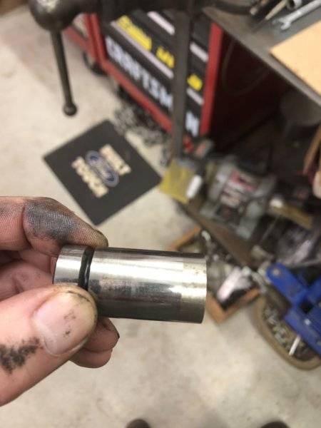

Just took another look and the lifter with the bent push rod is up high out of its bore but not laying on its side. Almost like I could just push it back down. The one with the push rod thru the rocker arm is not in the lifter cup at all but the lifter is still in its bore.

The 'up' lifter is probably stuck a bit because of oilresidue build-up on the lower part.
With the lifter way up, oil pressure is lost through the almost 1" hole on the bottom.

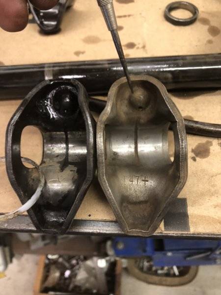

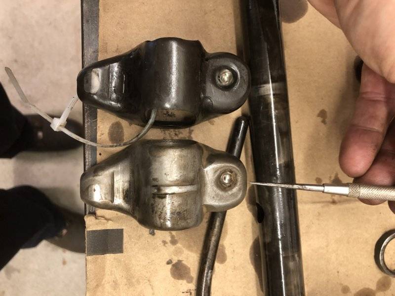

I was able to pull the lifter out with a magnet examine it. It looked like it survived was able to put it back down in the hole. I removed some old rockers and pushrods off the spare 400 which I know nothing about. I have them side-by-side now the one with the tire wrap is in my 383 now with the bent pushrod. Although they look very similar on closer inspection the pushrod has a different dimple on outside (383 much larger dimple). Also the bottom of the rocker arm is also different in the center can I still use these? I can’t really tell where the pushrod sets in to the rocker if the recess is the same. I do see they don’t seem to have the same part number stamped on them. The one from the 400 engine is stamped I47 + The one from my 383 that I’m trying to fix it it’s kind of hard it’s some kind a triangle with the number in it so it appears. The pushrods from my spare 400 or the same length as my 383.

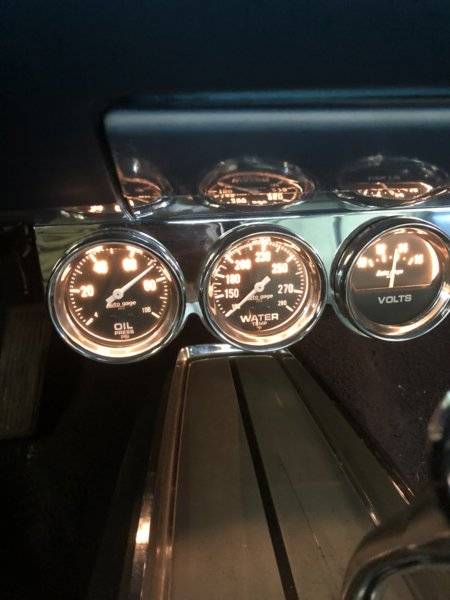

Update well I’m not sure if they’re the same exactly but I installed the 400 rockers and push rods in my 383. Spun the engine by hand a few times and the pushrods from 400 rotate just like any other pushrod to the touch so it looks like I might be OK. I have a mini starter. I don’t have the pump priming tool yet so I tried a few cranks and I instantly started seeing oil pressure . Should’ve changed my oil and filter first but but I will now. If this had been a performance engine obviously I would’ve changed oil and filter first. I’m sure I have a few metal particles in there from the push rod thru the rocker arm But I might just survive my sons likely first over reved engine.

Hopefully the rockers although different will work hopefully somebody will comment on that. Changed oil and filter and it started right up with good oil pressure (There was a few seconds where you could hear she was missing or filling a void with oil )but it went away in seconds. No ticking or other strange noises now fingers crossed.
Good to hear.
These rockers are def. not precision machined items, but the 400-rockers are most likely updated overtime and therefore have a different number in them.
I'm fairly sure they should be better than the 383 rockers.
