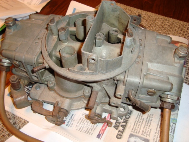

You know I think I have an 850 Holley sitting on a shelf in the garage??? I also have a box of Holley jets (or whatever they're called), like the edelbrock box.
treblig
According to Holley's PDF listing, it's an 800cfm, jetted 62/85, 0.025"/0.037" squirters...
