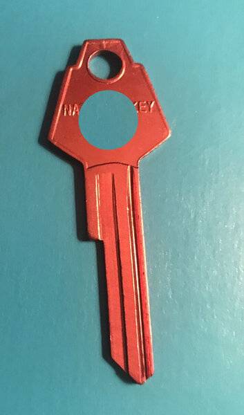

[QUOTE Like, take the trunk key off the key chain type of weight loss! Constantly yelling at me for weight![/QUOTE]
Well, how about an aluminum key with a lightening hole?
All keys are equipped with a lightening hole as produced, then some genius figured out you could put a ring through the hole and stack a bunch of keys together. Great idea for consolidating lightweight keys together, until you stack too many thus negating the weight saving effect. But, if you invest in a titanium ring you’ll be back on track for the initial goal of speed…and strength to boot:steering:
Like the redneck who had this gigantic ring of keys hanging from his belt, but the only locks he had was his pickup and double wide.
