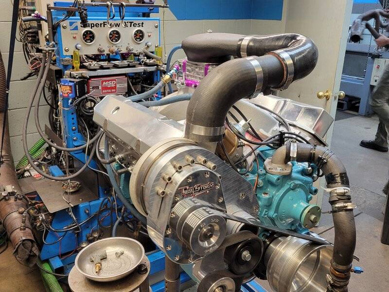

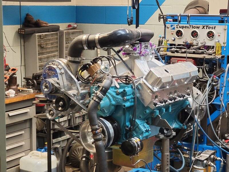

This thread is of particular interest for me--just finished testing a 461BBC Marine with a TQ-Storm and Sniper EFI/Hyper-Spark Distributor. I didn't build it or sell one part for it--just tested it. I was surprised when it produced 6psi @ 5500 rpm too considering the large 360cc rectangle port heads and Brodix single plane intake. Power was nothing to write home about but the compression ratio was supposed to be 7.5-1 and I have no reason to disbelieve that.
As you know @RAMM boost is only a measure of restriction to flow. The combo you tested was likely too efficient to make use of an entry level supercharger like a torque storm.
Making 540hp/560tI wouldn't use too efficient I would use big port , high flow, low port speed resulting in lower than expected boost--I figured 3-4 psi max. As I understand it the customer had TQstorm machine the crank pulley a custom size to spin the supercharger at max speeds knowing it is undersized to begin with. J.Rob
Yea efficient was probably the wrong word to use. But 461 inches with 360cc heads and a big single plane even at 7.5:1 I’m gonna guess you’d have to spin the guts out of the torquestorm to get it to make a big boost number. I wonder what a procharger F1 would do on that combo. I just finished an engine very similar for my boat. 468 inch BBC at 9.2:1 with 360cc cnc ported aluminum heads, roller cam, single plane and a blow through CSU 750. It’s getting an F1A-94 over the winter. I’m hoping for 900.
