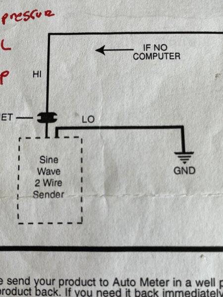

This is the AutoMeter diagram. The “hi” side they are showing is connected to the speedometer “signal” connection.
I can assume white is signal and black is ground and should be OK?
