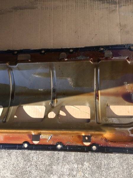

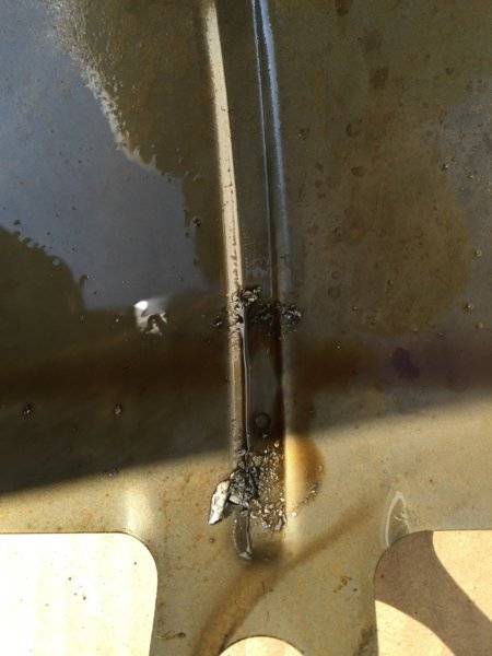

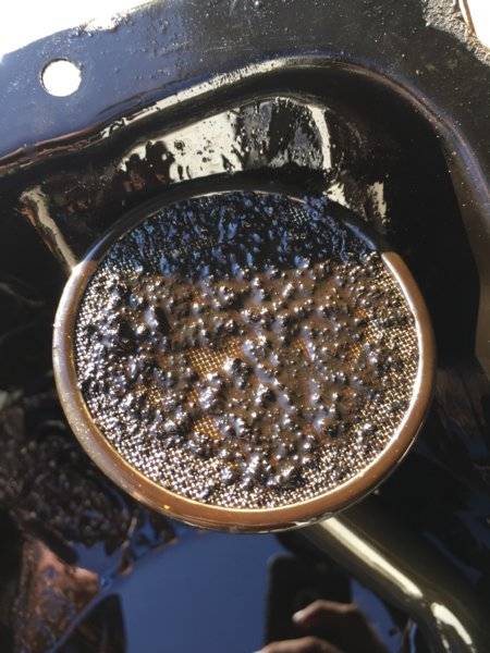

If the truck wasn’t maintained properly:read, oil changes, the pick up will get stopped up with sludge. This was my pick up on a truck I bought last year with a bad engine. It trashed the crank and rod bearings. Engine was super sludgy. Dosent help if you put something in the oil to “break up” the sludge. Has to go somewhere.
