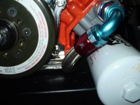

u will probly have to go w/ at least a single line external system, Good to 7000. If down sizing, throw that 4.5" crank in my ditch, I already have the single line deal !!

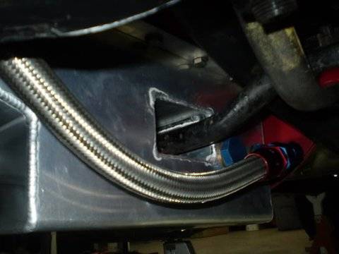

magnum force front end, no torsion bars, old alum. wet sump funny car pan, single external p/up. Still had to modify the front of the pan a little. The pan has the same measuremnts as the milodon 7 qt rear sump pan. Has a good ground clearance, not like the center sump pans at all.

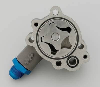

I run this combo. 4.500 stroke, 2.200” rod journals, Molnar H-beams and an internal 1/2” milodon pickup. It’s been 8000rpm with no oiling issues and regularly sees 7200. The pickup boss is slightly re-angled in a megablock.

Mine is 450 bore with 475 stroke, I run one external line. putting in HDK front end
I run external with a stock k frame. No issues. Although I was running wedge mounts. I’m pretty sure it would work with hemi mounts also.

Currently I have a Milodon #30190 7qt / 7"deep on the Flash....fits nice, drag link clears....I did a small modification to the idler and pitman to lower each approx 1/4". Milodon makes this pan with internal or single line extermal pickup
