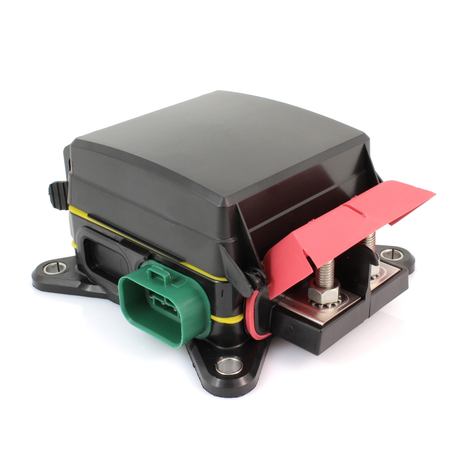

I replaced my cabin one because I just wanted to rebuild my harness with new terminals originally. It fixed a lot of issues with flickering lights and flakey switches. I ended up adding a bunch of fuses because that was the easier way to splice power as well instead of the factory setup, but I also needed more power points since my computer was in the cabin and some other stuff I added.
That makes sense. The later cars have a bigger fuse box and mine (in theory) should be in good enough working order to just leave it alone.
