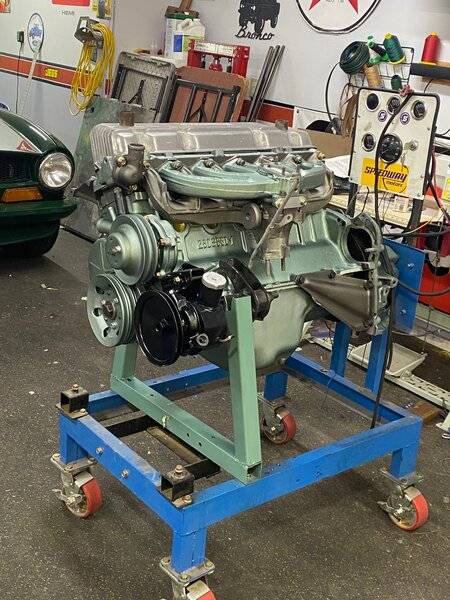

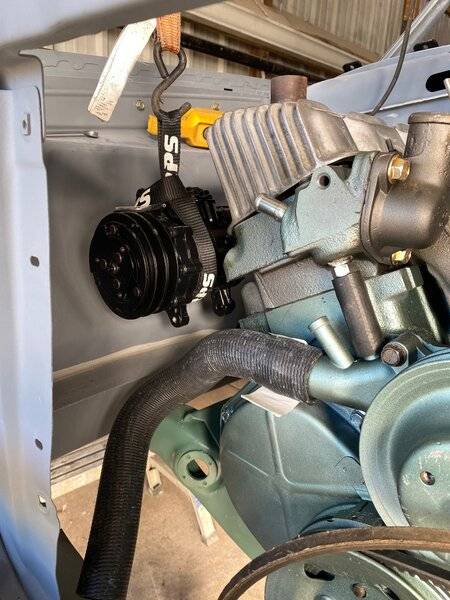

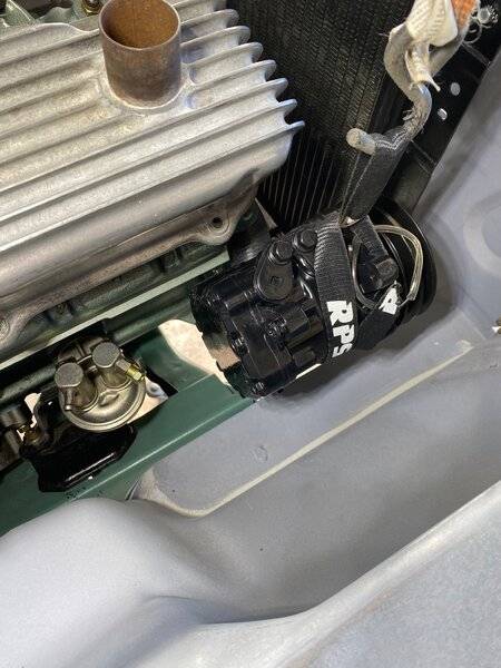

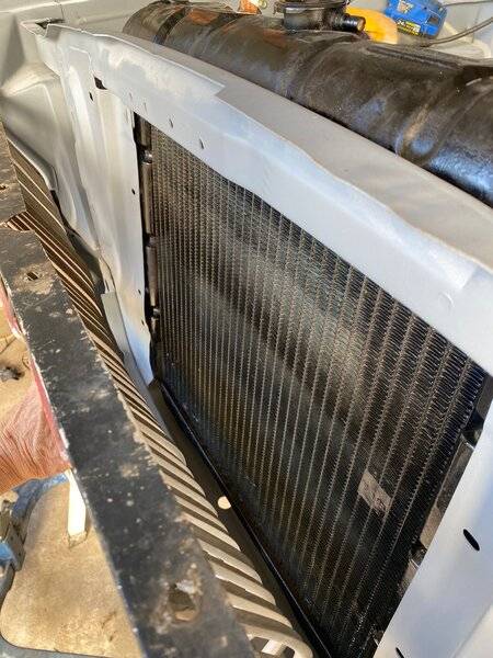

Once I establish where I want the compressor, I'll just have to take critical measurements once the engine it back on the ERS (engine run stand) to start the mocking process. The rough location I have here is looking pretty good, I'll use the two lower old alternator bracket holes for the lower pivot mount. The compressor is relatively light. Anyways, kind of excited to get on this. It'll be nice having all the AC lines on one side~ and plenty of room for a larger condensor;)
The miata engine I had installed the mini Sanden on it, so it's like doing this all over again :lol:
Actually, I guess I could go ahead an take it all down, I've accomplished what I set out to do installing the engine/trans: shifter location, AC location, found out needs motor supports, etc.

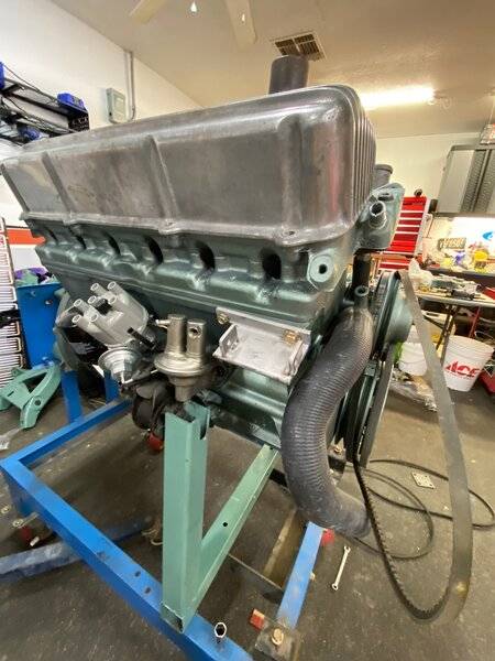

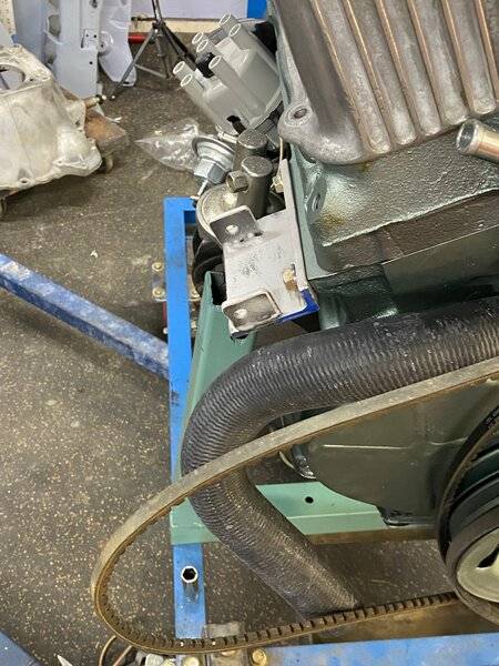

Winding up easier than I thought fabricating the AC bracket, a few minor adjustments, weld it completely, make the adjustment rod, clean up the bracket, make it look like it belongs there;) and then order an Alternator of sorts, must be relatively small;) Hardest part was going through my drill bits to find good ones that actually drill! grrr
Also good access to the spark plug

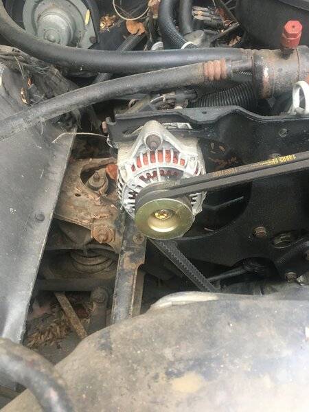

Looks like you have plenty enough wrap on the AC belt so it won't squeal being a single. I'm not sure if it's original to the truck, but my 88 D100 has a small alternator. Way smaller than what would have come on any 60's - 70's Mopars. I'm pretty sure it's a Denso alternator, but I will check when I get home Monday.
If I remember right, other than mine being natural aluminum finish, that pretty much looks like the one on my old truck. I need to open the hood and charge the battery anyway, so I'll get a pic of the alternator when I get home tomorrow. I've never paid much attention to the one wire deal, but I 'think' it means that the voltage is regulated within the alternator. I'd say that Ray, @halifaxhops can splain it exactly. :)
Thank you so much for the picture;) Is that considered a "mini", or what would be the application? ;) :thankyou:
I'll measure the one on my truck tomorrow for you, but I am sure it's smaller than any of the Chrysler alternators of the muscle car era. It's already dark and my butt found the recliner after a long drive....lol.
Hey no hurry, I did ordered the one I put a link earlier on~ but I'm curious about the one you're talking about too;)

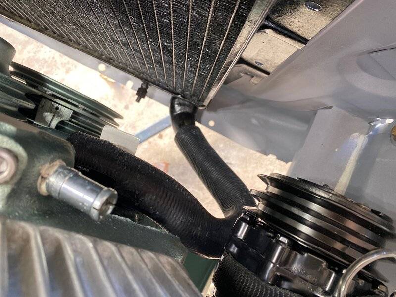

I had to unweld one of the pivot tabs, compressor was just a tad off. So, unweld, reweld a couple times, then I have a new adjustment are coming. But I can breathe now. If I can get the alternator in, get a carburetor, it shouldn't be long before I fire the engine, however going out of town soon:( Darned holidays, so it might be a couple weeks~ sad

Thank you for that picture! :thankyou: If the alternator I ordered won't make the cut, I'll take a closer look at your alternator;)

Hey! ;) IT will definitely be mounted on the drivers side, just above the power steering pump. As I have seen in my dreams, the bracketry will be coming off of the solid mounted power steering pump bracket, not the pivoting part of course, the stationary. As for a stock one, just seems like it'd be too large in diameter, but I dont have one around to test fit. The one I ordered won't be here until MONDAY! grrr! It has to be black to match the bolt on's, but that's easily done with spray paint;)
