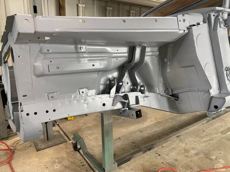

You can use the 73 and up disc brakes on you car and you don't need the 73 nd up upper control arms. Dr Diff offers some tapered ball joint adapters that slip around the small early ball joints and adapts them to the later spindle. They will work for you just fine using the early A upper control arms if you want to retain those nice disc brakes. Here you bees.

Just the same, I prefer the large ball joints, & those arms will fit in there if everything's correct...
I had a similar issue in my 70. The aftermarket arms wouldn't slide in between the tabs. I grabbed a piece of all thread and outfitted two big washers and nuts and just kept turning the nuts against the washers and the tabs spread apart far enough to slide the uca just enough to hold th tabs and remove the all thread. Then just tap the uca in with a rubber mallet.

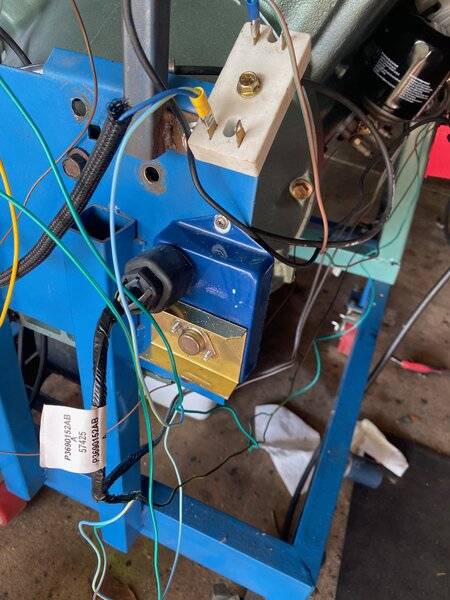

Hi, feeling better, not 100% but attempting a start on the s6. I have pump shot/gas, valves adjusted according to the cam sheet, but not getting spark~ I've tried different coils, tried another ballast resistor(one on order)~ I just don't know how to troubleshoot this system. Initially, it smoked/whiffed when I turned the key off, only a couple times. Test light on the +coil is hot, the (-) side is sometimes hot, most the time not. I'm checking fire by putting a spark plug wire near ground then turning it over to start, but nothing. Now I have this terrible headache! grrrr The module was from the Duster that it came out of. Let's start here;)
I'm worried to keep turning it over, I did put a lot of red lube on the bearings. and did pour a near quart of break in oil down over the rockers and down the lifter valley.
The ballast here is 1.5-8 ohms, the other side is 5.5ish
The yellow wire; I don't have a starter relay except on the starter.
I don't think the box is bad. I believe you're missing your "IGN2" circuit. That gives 12V when the starter is engaged. Run a wire from battery positive to coil positive and I bet it pops off.
